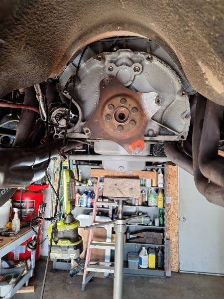

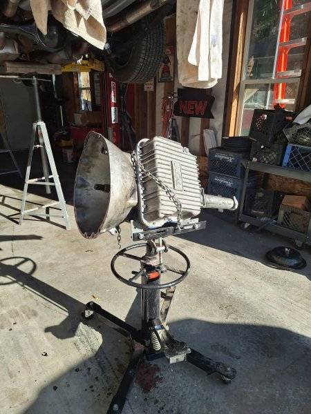

On Thursday we got the 727 out. Not without drama, but it's still much easier on a lift with a transmission jack than wrestling it out on a garage floor. We had left off with three bellhousing bolts in place along with the tranny cross member.

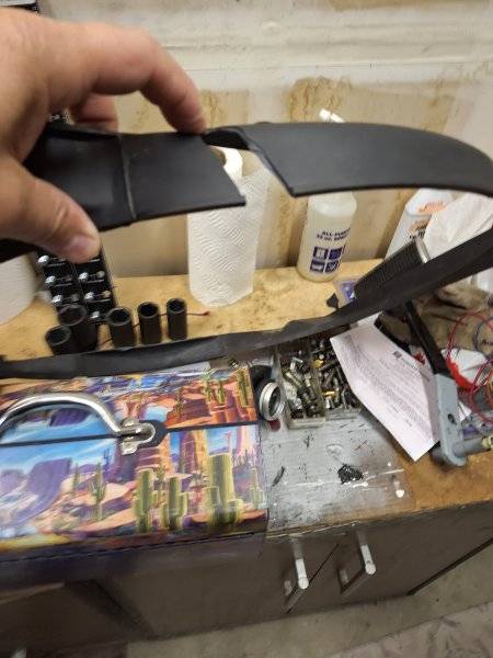

First things first, which I forgot to do: remove the fan shroud and if the fan assembly is close to the radiator, remove it too. In the Coronet, the fan blades are less than 1/2" from the shroud and the fan assembly, with a clutch, was only a couple of inches away from the Glen Ray radiator. After removing the cross member and lowering the trans jack down a bit, we heard a POP! It was the fan blade cracking the shroud. Fortunately the fan and clutch were still aways away from the radiator, but Greg removed the fan while I pulled the shroud nuts.
It's a clean break; JB Weld should bring it back together again with just a faint line.
Get some of this. Way better at bonding plastics. This stuff will actually do a chemical bond with plastic instead of just sitting there. If you have any connections at a body shop, they should have some, or similar, around. At the shop I managed, we used this stuff to repair door panels where mount tabs were broken off, trim pieces etc. It gets hot when its bonding due to the chemical reaction.
3M Universal Adhesive Black - 3, 08223, High Viscosity, Gap Filling, Durable, Industrial, 200 mL Cartridge
With the shroud and fan assembly removed, we were able to remove the three bellhousing bolts. They're a lot easier to access with the engine/trans tilted down a bit. The trans slid back enough to remove the torque converter, balancing out the fore and aft weight of the transmission. Here's we we ran into the next issue. The header collectors squeezed in towards the center enough that the bell's starter hump hung up on the collector. And we couldn't pull the tranny straight back because of the H-pipe. We wrestled the trans around, lowering up and down, but it wasn't going to clear. So we're contemplating: remove the driver's side header bolts, or cut the H pipe to gain clearance. The headers attach to the block with studs and nuts so backing out the nuts wasn't going to gain us much. Cutting the H pipe was considered, but that would require a trip to the local muffler shop afterwards.

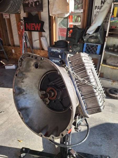

It was Greg that came up with the solution. Loosening up the chains that held down the tranny to the jack, we rotated the tranny 90° so the starter hump was facing at 12:00. After that, the tranny dropped right down! I didn't get to take any pictures while this was going on, just the end result. As the saying goes "the ends justify the means".
It took about 2 1/2 hours and a lot of shop rags cleaning up tranny fluid to drop the beast and load it into the bed of my truck.
Thank you. I've used their panel bonding adhesive before so I already have the applicator gun

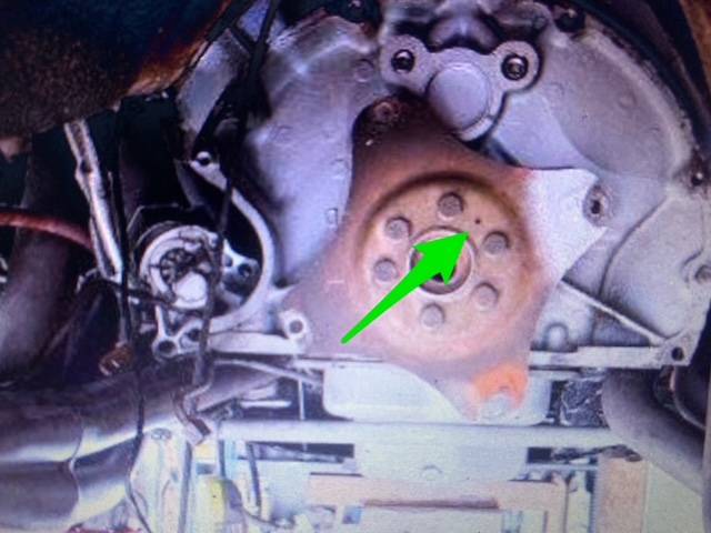

Not helpful for this swap but for those who are following & still playing with automatics.... If you should have the trans out & neglected to mark the torque convertor to flex plate... Well Mopar marked it for you...
See the little hole in the bolt circle at about 1 o clock? Well the torque convertor drain plug needs to be 180 degrees away from there...

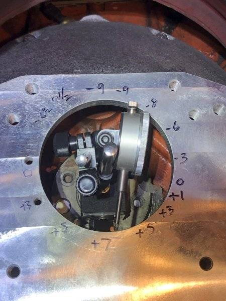

For me, the two most difficult parts were the measuring of the bell housing runout and the final stuffing of the transmission into the car.
I love to learn from my past mistakes so here is what I've thought of.
If Rich wants, I'll modify the linkage rods of my dial indicator by shortening them to allow the needle to point at 90 degrees instead of this angle:
Next, some light lube on the input shaft and the pilot bearing may help the interface. I understand Rich's kit comes with a trans yoke but not a drive shaft. Slipping the yoke onto the output shaft would allow movement of the input shaft in case the splines are butting into each other instead of meshing.
