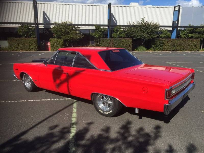

Ok...I understand there is already a current question about the ‘best’ options - but I am already committed to TTI mounts for my 6.1 install.
Ive already done an install into an Abody, and wasnt impressed with the motor alignment created by the TTI mounts.
This car is a 67 Belvedere, TTI headers, manual steering box, no air con.
Can anyone advise am I going to hit any problems and if so, what?
IE...Grinding the passenger mount, fouling the TTI long tubes etc.
Thanks in advance.
Mal

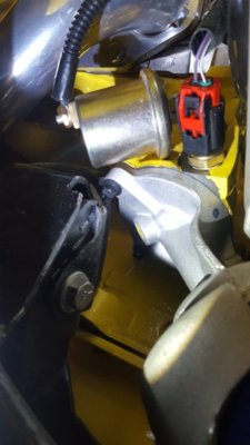

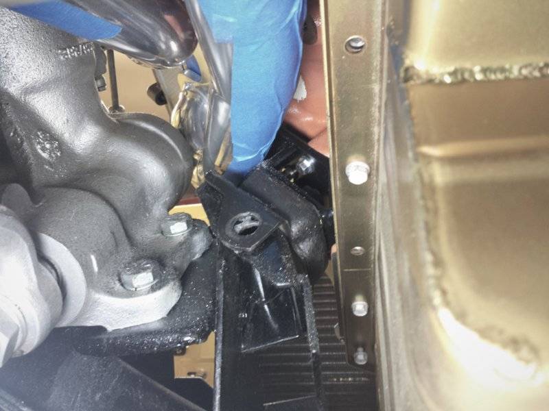

I used the TTI mounts and headers in my 66 belvedere with a 6.4l , In general they fit pretty good a little grinding on the passenger side if you're using the 45 degree oil filter adapter and I think one corner of mount(thought i had better pics but, sorry) and then a little more grinding on the passenger side to clear header tube. All in all.. not too bad.
