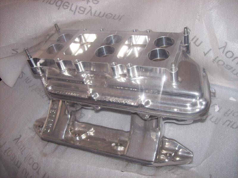

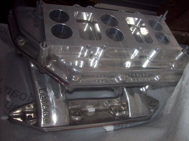

Because my 70 Roadrunner is a V-Code, even though I'm using a BMP aluminum block for a 541 stroker build, I will not compromise on having anything but a 3x2 intake. I did get the old school Super Stock Weiand P3690982 6bbl intake, which is a single plane design.
Indy also offers the ModMan intake w/a 6bbl top.

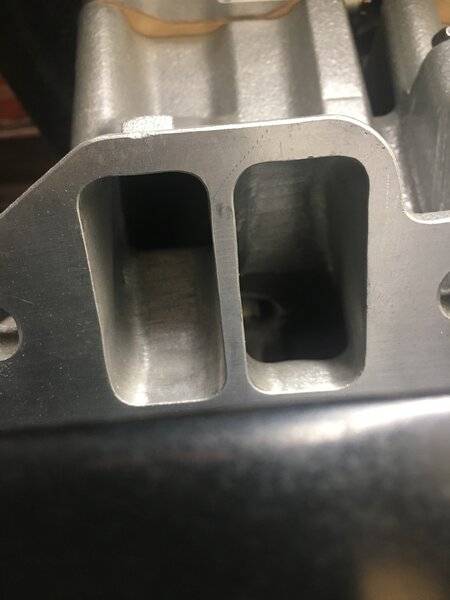

I know the Weiand single plane I am going to try to get the most out of will be finicky, may need mods to the intake (to use on my current 440) certainly will need to be opened up to Max Wedge ports (no way I'm running TF 240s on a 541 cu in engine). So I may lose torque and torque over RPM range, but I suspect my ultimate goal, the 541, should make up for that.

If the Weiand works out, I'm getting it polished!
