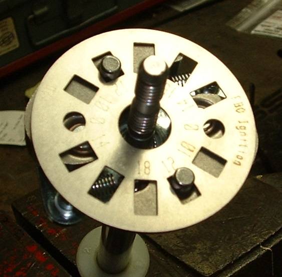

Long term plan is to either pick up the FBO kit or replace the reluctor with the pertronics 2 module. I've read mixed reviews about pertronics, so I'm not sure yet. I also plan to rebuild the holley 750DP and try it out, hopefully before the snow flies!
