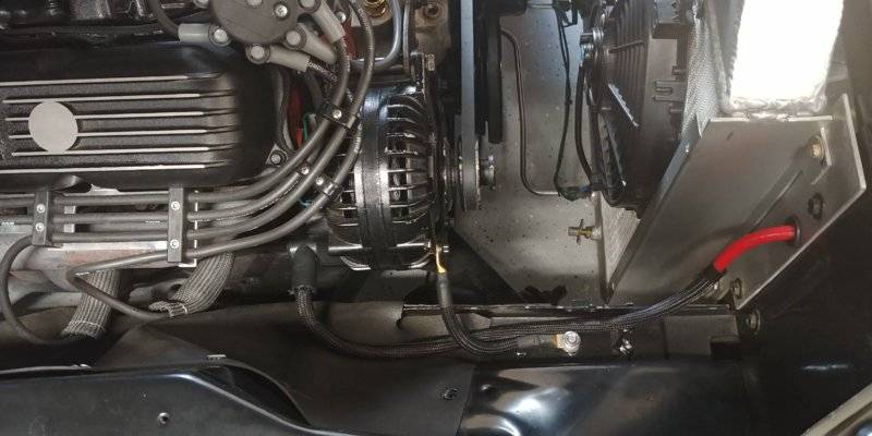

So i did the mad electric mod on my 71 RR a few years ago. I now want more output at idle (added ac and elect. fan for condenser .) So now Upgrading alternator to powermaster 100 amp.
I used a 10 gauge wire as recommended in the mod. Powermaster calls for an 8 gauge up to 6 feet. Would you guys recommended redoing and replacing. I dont know if i will ever draw that much output?
This site is helpful and they will sell lengths of any size and color cable and wire. Quality multi-strand primary wire is important. The rule of thumb for a DC circuit is to add up the max amperage for each device, and then compare that amperage draw to the chart. #8 is rated for 80 amps.
