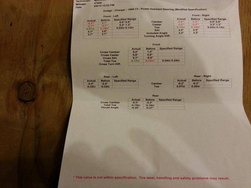

Don't look like on the print out a caster sweep was done after the camber adjustment it has be be remeasured after any cam adjust at all
It would have chanded some with a camber increase.

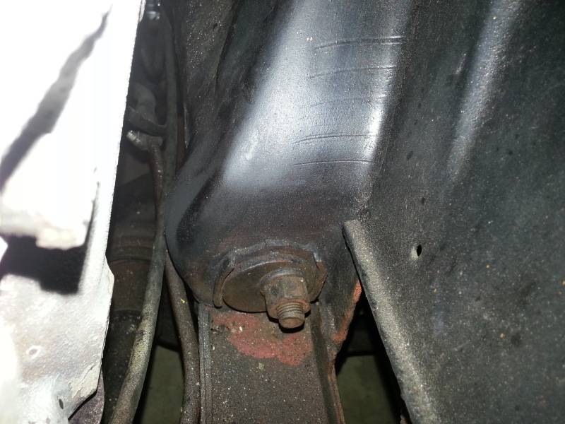

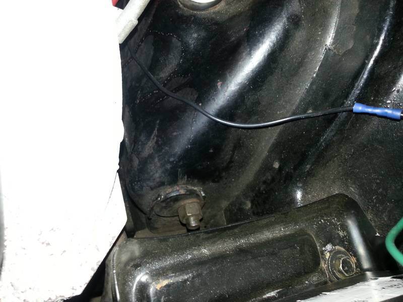

Can you post pics of the cams where they are at?

Driver side front. Couldn`t get the driver side rear.
Pass side front.
Pass side rear.
Yhea They are all the way out in the front and the back maxed out for camber. No way they're going to get the camber and caster up with that.

Being power steering you need at least 4 degrees more
