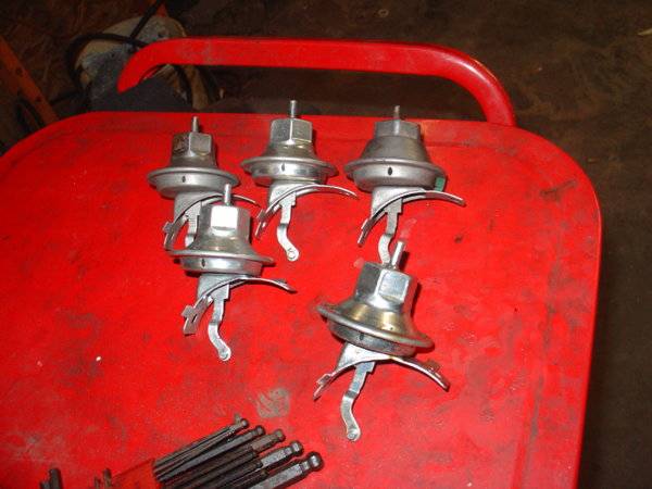

I have some and a few nos left, depending if the arm goes inward or straight. The straight ones are getting really hard to find for some reason.

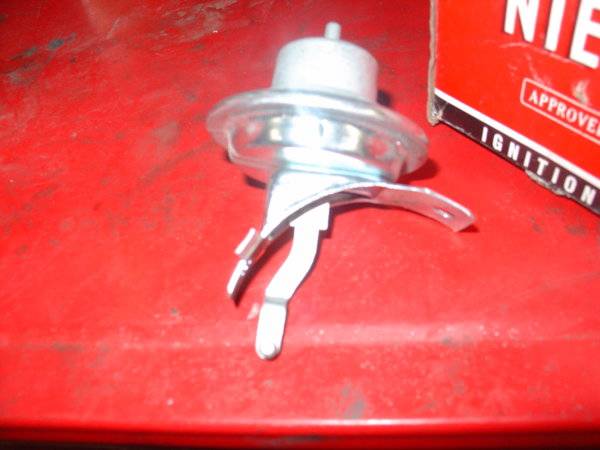

Any luck on this ? I just found my can dead on my 383. Points distributor with pertronix ignitor 2... i pulled the can and searched for hours with no luck. Nothing looked the same. Luckily, or so I thought, mine had a factory part number on it and I took it into Napa. Thumbed through their books and found a match, part number crossed to a vc3033. Special order, part came in and the arm does not match ! I don't know what else to do other than order a new distributor....... this sucks for sure
pretty sure points use the straight arm and electronic the offset.

Is the VC155 that rockauto lists the wrong one
they have good pics
