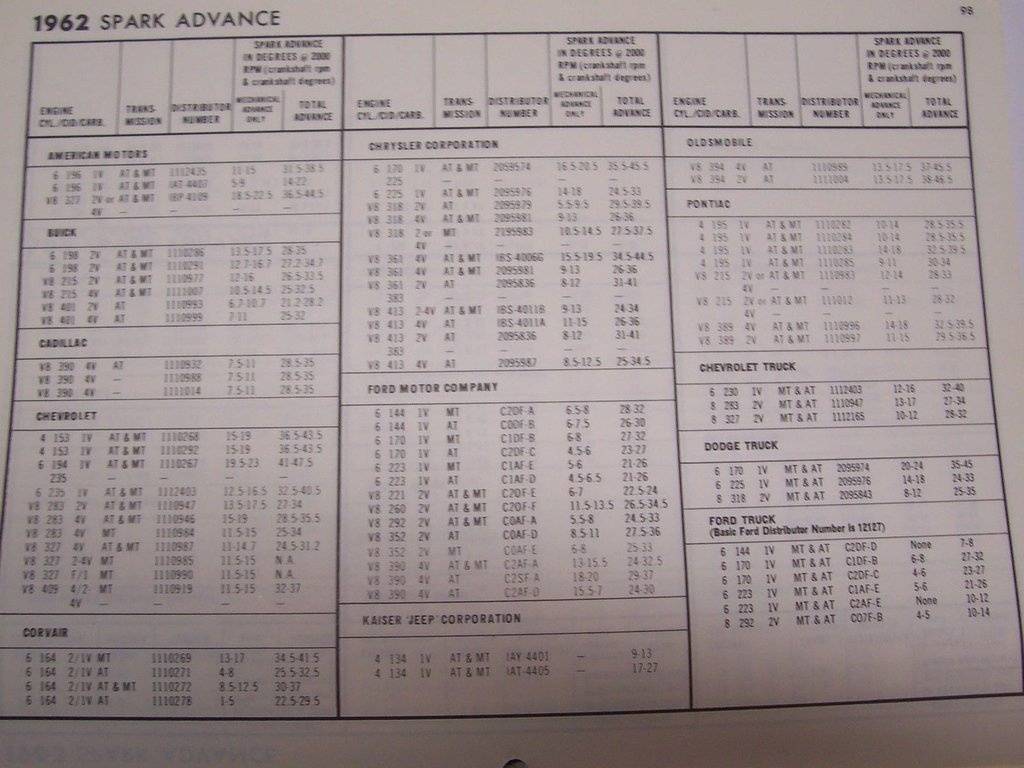

PM the dist number and I can give you the factory specs at least to start with to get a baseline. Remember specs the total is mech adv + vac advance = total advance.
Yes that is the mechanical, the vac usually does not kick in until around 7"hg or so on average, when I run them on the machine I do mechanical first then add the vac to get the total at rpm. Here is a example of the specs if you can read it, some times easier to see it.
Understood, but your post can be misleading as your combining initial and centrifugal as mechanical. If your worried about performance at WOT, to help determine where you put initial timing, you have to factor that in separately. Initial Timing + mechanical advance of distributor weights + Vacuum Advance = Total Advance. Spring tension, and vacuum curve effect all this. I know you know this, just think as stated may not help those not as knowledgeable on how it all works. Seeing it on a distributor machine helps you see how it all works.
Finally, too much initial with light springs and the car may be hard to start.
Totally agree just going to throw easy numbers out the timing at idle on the balancer is set at 10 btc, then it has 20 mechanical advance at 2000 rpm and the vac advance is 10, then total timing is 20 positive. Hope it helps someone.
