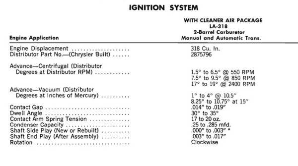

Small Block. My 318 has a 9.5 degree vacuum advance stock. I am looking at replacements but none of them say if they are adjustable or what the total timing advance is. Where can I find one that is either adjustable or I can get one with more like 14-16 degrees?

Because small blocks like about 32-34 total mechanical and about 50 for cruising so I am trying to hit that number. I only have about 42 with the vacuum now and 34 total mechanical. I will likely need to modify a cheap one from Summit.

9.5 stamped on the arm? I was under the impression that that number was crank degrees and that the true number was cam degrees, same as the mech adv plate (9.5 x 2 = 19 degrees vacuum) I may be waaay off here so I hope someone can confirm or deny.

Yes mine is one without the "hex" end and is marked 9.5 on the arm. I have a high dollar Snap-On timing light with an advance dial. I have the advance on manifold vacuum and at 3000 RPM all I can get is about 42 degrees. Unplug the advance and I get about 32 degrees so I interpreted that as the can gives me about 9.5 degrees.
Now you mention it I know my weights were marked with 19.5 or something and I decided that with the 2 degrees ATDC on the emissions tag that would give me 34 degrees of timing when full in so the 2x theory makes sense......
Wonder if my diaphragm is getting hard and not pulling in all the way.... I need to buy a vacuum pump, my old Snap-on does not work any more.
Or I am thinking about this wrong and at 3000 RPM my vacuum is not high enough to pull it in all the way..... I need to look at it at idle.

Ok I spent more time trying figuring this out. It is clearly only getting about 10 degrees of advance with the Pertronix III, and it was clear (based on me rereading my build thread) that with the points I was getting more like 20. I have this nasty feeling that the magnetic fields that the Pertronix III use to fire the coil against the points cam are not sharp enough and get smeared out. The real electronic ignition reluctor is sharp gear teeth not the soft bumps for the points.

Is that what those numbers are? I have had people tell me that it is the amount of timing that is added to the distributor, so multiply it by 2 for the crank timing. I never got a definite answer.
The number on the arm is for the amount of distributor (cam) "DEGREES", not pounds. The number is multiplied by 2 to get the amount of crank degrees.
Awesome! Thats what I thought. There is also an L or R on some of them to tell which way they mount in the distributor depending on its rotation I believe .
And if you do the math with a 2 degree ATDC initial + (19*2) = 36 BTDC total mechanical + (9.5*2) = 55 BTDC total. Just about right, maybe a bit more than ideal
