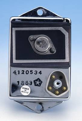

Orange box has been having some reliability issues over the past few years. If you got an older one, they are awesome. The newer ones I guess are less than stellar on reliability. I also have heard from multiple credible sources that the Chrome box is still made pretty well, but the orange boxes take a crap pretty quickly. Again, this is the newer stuff. I personally had an orange box fail after only a couple years, so I can kinda vouch for the issue myself. Only difference between the boxes is the spark will remain hotter up to a higher RPM and the timing retard feature is not present on the Chrome box as it is in the Orange box. I would get the Chrome box for the extra coin if it were me. Summit was about the cheapest I could find it.

I got 3 chormed units gone in 2 years
culprit... transistor.
Replaced one of them with MJ1005 transistor ( the closer to specs I could find locally ) and FIXED the box, just didn't last long maybe due the same quality issues fo the original ones...
got a real NOS MJ10012 pair of transistors and fit one of them. Waiting to find a car to test it ( my car is dissasembled since 4 years ago )

They are 400V 20A parts..... If it is not thermal then I would guess a coil that does not have 1.5 ohms and 8mH of inductance or the base drive circuit is crap and keeping the part in the linear range too long.

Oh, forgot to say... FBO box failed with FBO coil. MP ones failed with MSD Blaster 2 Coil ( an OLD one which is a smalled diameter canister than newers ). Coil is still running ( or it was last time I used my car ) with Rev-N-Nator module strong
