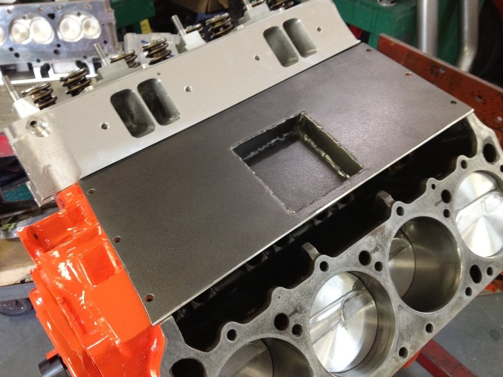

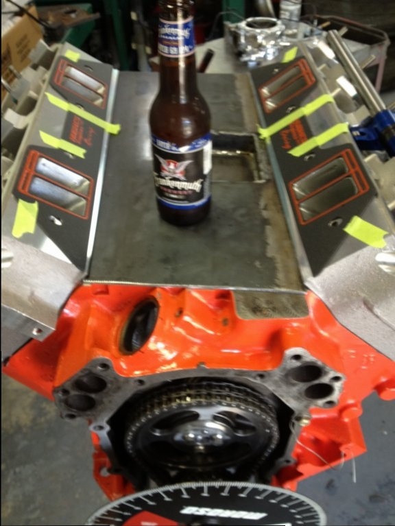

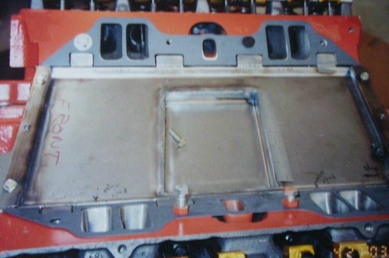

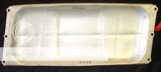

i made this one some years back for an iron head 6pak set-up. takes a little time and thought but not difficult to fab something.

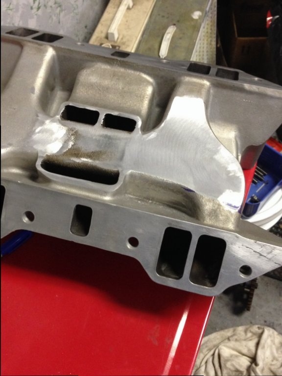

For my 511 I just wacked off the heat cross over and run a Indy with removable lid.
