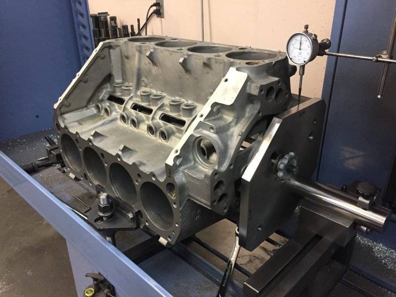

Steve often when these blocks get decked the shop does not account for the front and rear 'china walls' unless being told to mill these by the customer. (Real mopar builders will do it without being told!) Aside from the obvious intake/head surface possibly needing milling to fit, if the only thing done is the actual deck surface, a stock valley pan can be thrown into all kinds of caddywompus...even if the intake bolts down okay. Leaks under the pan, at the bottom edge of the intake ports is common. If you're having issues maybe look at hughes' 2-piece tray. Takes a little more work to install but they've worked good for me in the past.
My current build the heads and intake were milled more than the norm for the build configuration I wanted....Stock valley pan was used and no leaks....So?
You have to have the "right" builder......
Being one of those "shops", I need to disagree. I always cut the valley rails, even when the intake doesn't seal to it. Yes, it does make the valley pan seal better, but is not absolutely necessary. I usually am the one telling the customer what needs to be done, why it needs to be done, and how I am going to do it. When the customer understands why something needs to be done, he doesn't feel like he is being taken advantage of. When I "Square" a block, I use a BHJ fixture to ensure the angles are correct. I also align hone the block first so that the main bores are round and straight. Everything has an order, and each step properly sets up for the next one. Also, when you use the BHJ Block True fixture, you know the block height, and can ensure both decks are the same.
I don't really see a disagreement? You are obviously one of the guys that knows the ins & outs of a mopar engine; sadly not all shops do..at least around here. I always appreciate when you and the other pros weigh in..
Hence, no red X... :thumbsup: I started out learning out ALL I could learn about Mopar, but being a machine shop, I have to know a lot about a lot of different motors. I like to think I am not like most other shops as I try to go the extra mile for customers. Oh, and do it properly... :)
