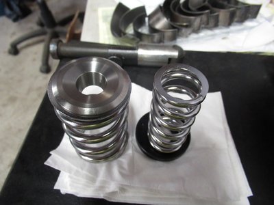

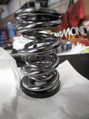

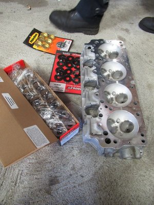

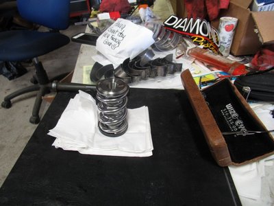

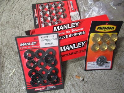

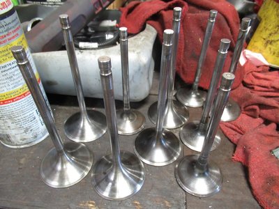

I just bought a set of Manleys from Marsh performance.Todd was very helpfull going back & fourth with measurements and spring rates.So new springs,titanium retainers and .060 cups.
6.1.17 026.jpg 6.1.17 037.jpg 6.1.17 073.jpg 6.1.17 074.jpg 6.1.17 076.jpg 6.1.17 080.jpg
