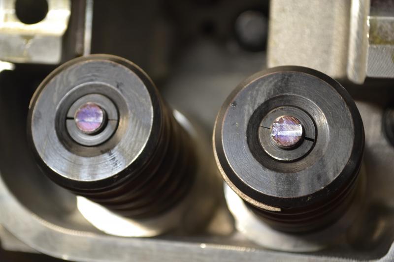

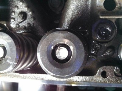

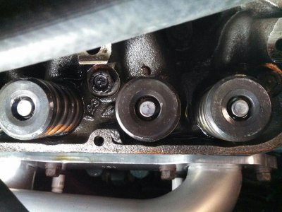

I've been fight a bit of valvetrain noise for a while, I've isolated the sound from the passenger side. Initial thought was a bad lifter not pumping up, so ran the engine with out the cover. Noise was still there, so that ruled out the rockers hitting the baffles. While running the lifters seemed to pump up fine. Dug a bit deeper and pull off the rocker shaft and rocker arm assembly to check the pushrods to see if they might be bent. Upon removing the rocker shaft, it seemed to be well past the recommend 25 pounds, which drew a red flag. As I read you can oblong the rocker shaft if you over tighten.
Moving on, all the pushrods looked ok, seem to roll out fine, but I rolled them on a piece of cardboard. I probably need roll them on a piece of glass to be 100%. Upon inspection however I came across what looked to be the problem. The rocker arms appear to be coming in contact with the retainers, causing what I would assume to be a tapping noise. I check the side to side measurement on the rocker arm and I can fit a .004 feeler gauge. The book say it should be be .001-.003.
I am running a Comp XE274 Cam, the valve springs are comp 911 springs. The retainers are comp retainers, I will have to check the degree on them comp lists a 7* and 10*, I don't know if that matter or not.
I guess what I need to know, It seem to me the rocker arms are too worn to reuse, but can you even run stock stamped rocker arms with that large of a cam or should I be looking at a roller rocker setup?
ResizedImage_13938632287961.jpgResizedImage_13938633873311 (1).jpgResizedImage_13938633873311 (1).jpg
is that 8 degree locks with 10 degree retainers?
It's certainly possible. When I had the engine builder put the top end together, he called and said the retainer were not wide enough for the new springs. The one I had on there were the original retainers. I will have to check what I bought. Would that be the clearance issue?
I had what I thought was a bad lifter on the passenger side that turned out to be a worn fuel pump shaft.
looks like a real mismatch. don't drive it until you get the correct parts installed.
Top photo, valve end on the far right, looks like it's dished. Bad wear, or was it ever fixed. Are the valves new, or used?
Those valve locks are sitting way too far down in the retainers....and as a result the retainer is up too high on the valve stem.....No wonder the retainers are hitting the rockers.....Those parts are badly mismatched and it's a good thing you looked before a failure....good call...

Yep.. definitely have 10 degree retainers on there, found the receipt. Thanks all !

Pay very close attention to the lock grooves in the valves. They may have been damaged. If so scrap them now before you break a valve and it falls into the cylinder at speed. It's scary that the engine "Builder" put this combo together. I hope the rest of the motor is OK?

The rockers hitting the retainers will act like a spring compressor. It's a matter of time till a valve drops.

By the looks of the dish on your valve stems. I'd say start from scratch, with all new valves and the correct locks. Be sure to check valve stem height or length before assembly(not talking about spring height) , unless you are using adj. push rods or rockers. If to long will hold valves open, if to short (not likely) lifter clatter.

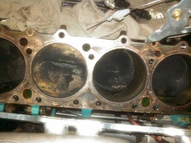

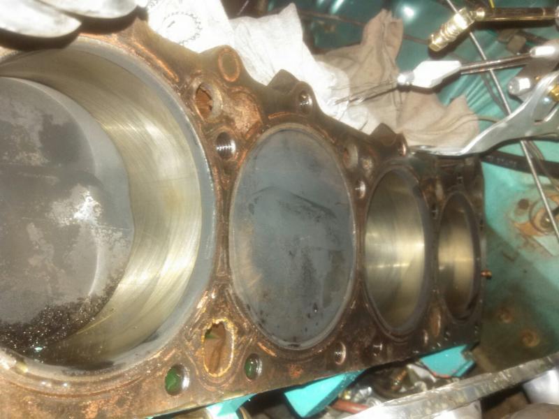

So I pulled the heads this weekend.. surprise..surprise.. I have one 346 head and one 906 head. I think a moron put this top end together.

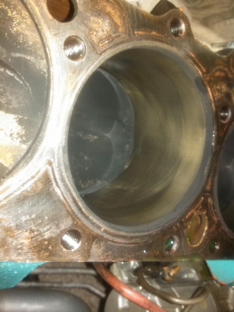

The somewhat as expected news was I definitely have KB 162 pistons and they are .025 in the hole. I will post some pictures today, when I have the chance. The cylinder walls look good to me. The steel shim head gasket has definitely left a imprint on the block, i'm not sure if i'll be able to run another one or not.
Wow! Glad you dug into it, and found things out.
Don't know others feelings about steel gaskets, but I've never had any probs with them. Imprint on the block...can you 'feel' it. Over-torqued?
