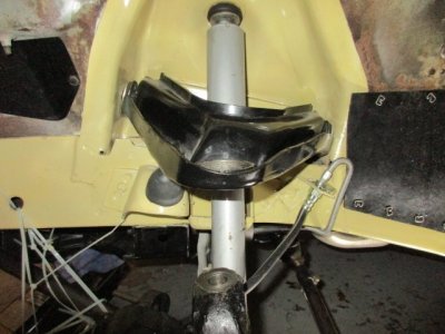

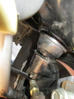

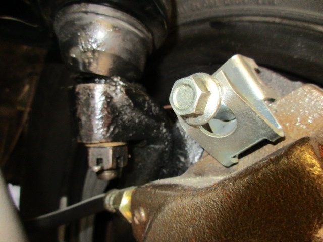

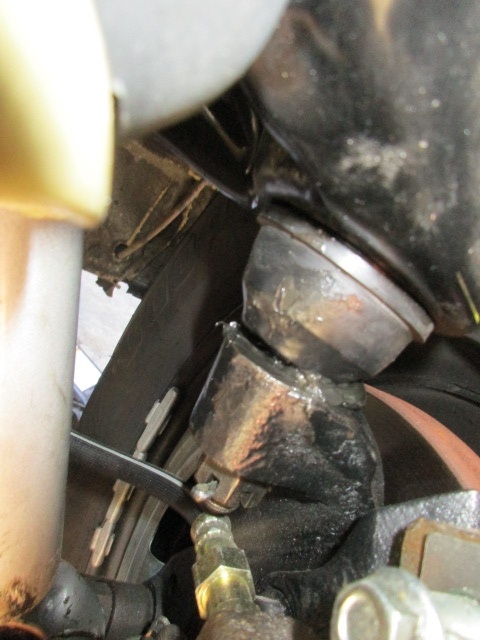

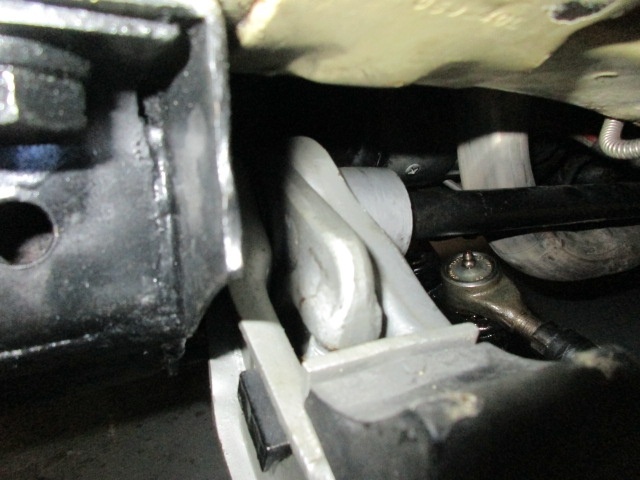

I've had a rattle knocking sound comming from the left front for awhile now. It just started to tranmit a vibration through the steering wheel the past couple of times I've had it out. I jacked it up and founda tiny bit of play in the upper balljoint. In the pictures it looks like it has seperated but it has not. What do you guys think.
Time for new ball joints.
Tiny bita play in the ball joints = a whole lota adventure.

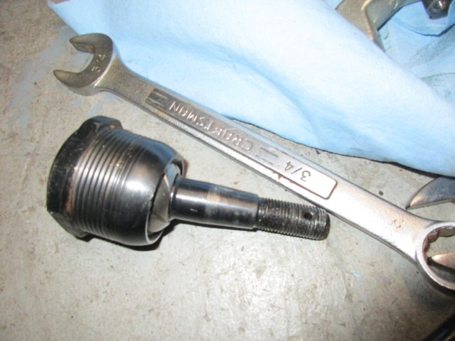

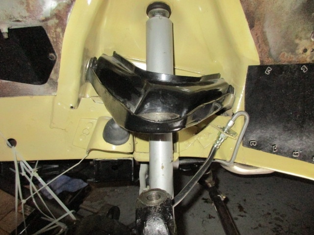

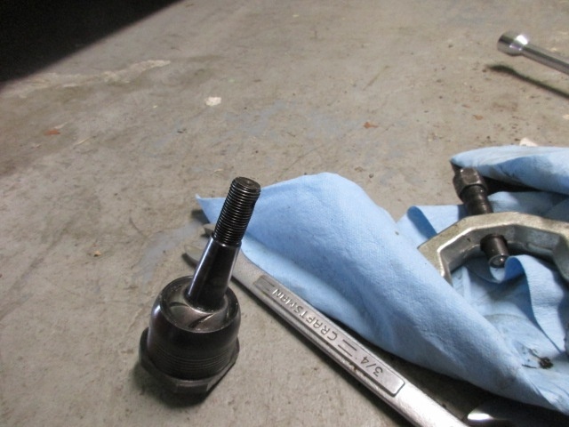

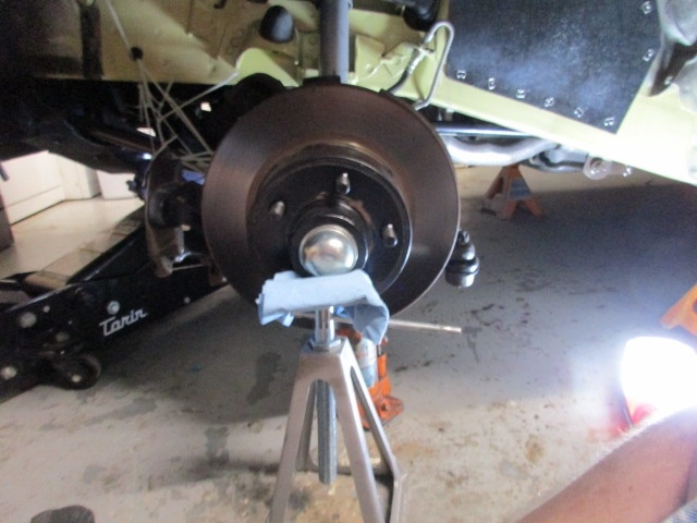

I had some extra time this evening and got the ball joint out. I checked the torque on the nut after I got the cotter pin out it was good. It has one spot that when you move the shaft around it hits it and binds up. It also feels like it's grinding against sand. Physically it doesn't too bad.

I went to install the new Moog balljoint now that I'm feeling better. They didn't fit properly. Also they wouldn't tighten and were loose in the hole. The old one will tighten but not these new ones.
So I ordered different ones. Hopefully they will be here soon.
