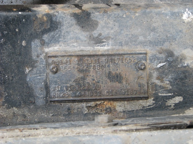

Wanna take a stab at decoding??
max340
12:05 AM
Jan 23, 2013
249
109
San Diego
Ok this much I know. 1969 satellite, 383 (maybe 4 barrel), four speed, two door hardtop. I wish I had a better pic. Maybe your screen is better than mine. Thanks!!
put a sheet of paper over it and rub a pencil over it.
the letters and numbers will appear much better than that pic you submitted.
A better chance of getting correct feedback if you do that.
Matt
Looks like a fairly low option car built at Lynch Road (which could negate the low option suggestion).
E44 D31 B16
If that's RH... E44=318 d31=904
B is a brakes, but i can't find 16.
V(W)1 H2X X9 + ?? high bench seat, black, something else black.
gate sequences
Sure looks like a 68 tag
and the back windows roll down.
Hmmm.
E44 D31 B16
B is a brakes, but i can't find 16.B16 = scheduled production date of November 16 (1968)
V(W)1 H2X X9 + ?? high bench seat, black, something else black.W1 W1 = White top and white body. H2X interior = High trim level, vinyl bench seat; black. X9 = Inner upper door frame painted black to match interior
gate sequences
Sure looks like a 68 tag you can tell it's a 69 LR tag by the 9A in the upper right hand corner
Hmmm.
Thanks guys. That's about all I came up with as well. The car's on the other side of L.A. and I'm in San Diego or else I'd get out the paper like mguesto said and do a rub. I think the 383 and the 4 speed have been added. sequence/serial number match vin on dash.
