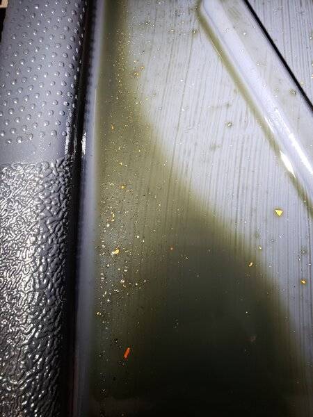

The only other thing I figured I'd check is the old oil filter, see if there was any chunks in there. Cut it open and definitely see a little glitter, mostly in the oil itself, there are a few flecks stuck in the filter material itself but not much at all. Sort of gold-ish/silver in color. I'll try to attach a picture (sorry for the quality), the orange bits are engine paint that fell into the pan while I was working. I know a little metal is normal, not sure how much would be concerning.

I hate to say this but those bits don’t look good. That gold color is typical bearing failure stuff. Been there, sucks. I’ve also been in the “I’ll see what happens” spot and grenaded a nice 440. I was 17.
I’d pop the steering link and drop the pan. Then one by one pull the bearing caps and put them back. You won’t sleep well until you do.
Thanks for the replies. Kinda what I figured I was going to hear, unfortunately. I'll drop the pan and see what I can find, pan was leaky anyways.
