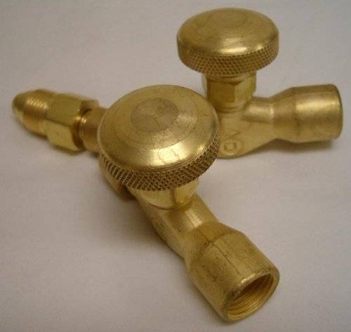

I did notice small brown spots on the practice welds after lowering the flow, thank you for that extra information. I did have the flow at 30 with no brown spots but thought I might be using more then needed. Back up to 25 30 where I started.25 -30 is a good starting point. I'll run upwards of 40 on a flow meter. They are the best for a nice flow. The guages are fine for what you have. If you are noticing a brown color on each side of your weld, you need a little more gas. Don't blow air across your work. Place the fan so that it pulls the smoke away and just keep your face out of it if you can.
Happy Welding View attachment 604918
This reminded me that I forgot to turn the bottle off after I used it. I must have a slow leak when not using the gas and now I'm pretty low on Argon for the TIG welder. Usually I just set for 20 CFH with the smaller 180 A and less MIG welders (smaller mig torch/gun). I could use less flow for most stuff, but usually I am welding just inside the garage with the garage door open, so not the ideal environment if it gets windy.
