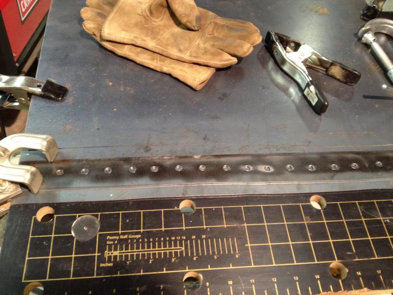

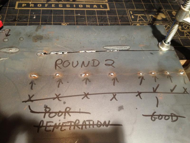

I made myself a test weld out a piece of flat steel. I am not sure of the gauge, but I think it is 18 gauge (measured about 0.050"). I cut a section off and then drilled 5/16th holes in that. I also cut two long cuts in the remaining piece so I can butt weld and plug weld some.
I then checked many of the items that were suggested before I started welding again. I increased my heat range by one notch and decreased my wire feed a little bit. But the Aha moment came when I checked my wire. I have flux core 0.035" wire on the spool. Previously, I did not use gas. So now I need to buy a spool of the proper wire.
Then I will try again. I wish I had more hours to devote to this, but it is what it is...
Thanks for the continued help and encouragement! I will check back in once I get the proper wire and weld a little bit!

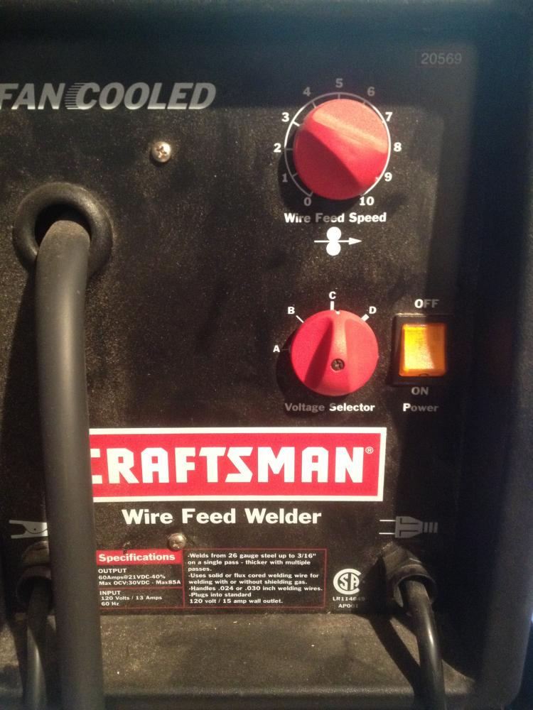

Changes I made: I purchased 0.025 non-flux core wire (they did not have 0.023 where I went). I also reduced my wire feed speed and increased my heat setting (see attached picture of welder). I left my gas speed at 20 CFH. For you newbies like me, note that your welder needs to have the proper pinch roller size, so check this, and the correct tip size too. Check this out to be sure it is right on the welder.

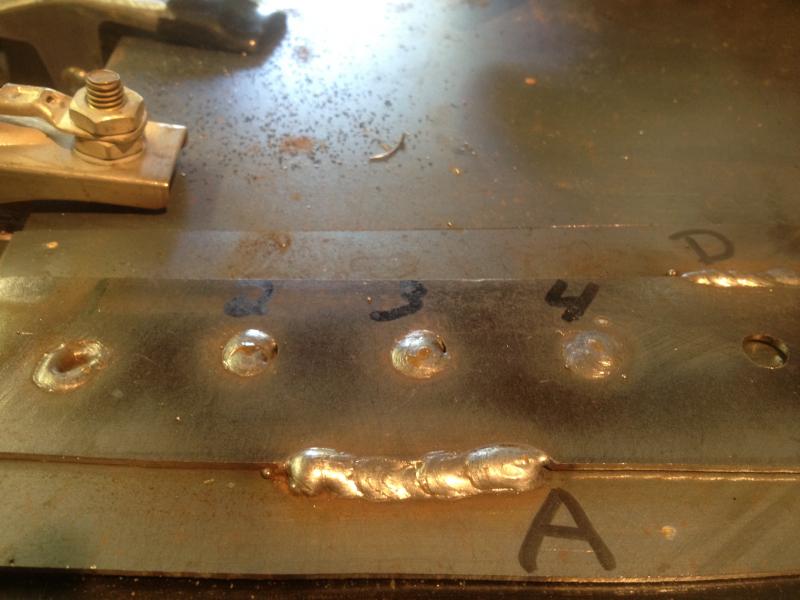

So, some results:
The first weld I did with the new setup was lap joint weld A to stick my metal together. Not so good and a bit shaky.

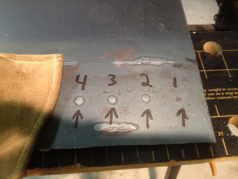

Then I tried four plug welds. Thanks to 747mopar's great advice, the plug welding quickly turned out nice. He said to start in the middle and then when you get a puddle, work around the perimeter of the hole. You can see the first plug I was way to fast. Then on welds 2 and 3 I got better at filling in the hole. By plug 4, I was more patient and got what I think is a very nice weld.
Weld F is another lap joint. Still not great but getting better.
Welder settings.

Wow, that looks great. Looks like you already have it under control but I thought I'd mention that the small holes in #2&3 plugs will let moisture threw and allow rust to start but like I said judging from #4 you already have it under control "remember not only are you welding but sealing it up as well". On your lap joint "you don't want to run a solid bead on sheatmetal" it will warp it. Spot welds spaced out 2"-3" apart, then continue spot welding (never closer than 2") until it's a solid weld made of nothing but spot welds. Man, I had fits with this on my hood and almost scrapped it, it just takes practice and unfortunetly screwing some stuff up to figure it out. You made some good progress and should be feeling a little more confident about your project now. Do you have a wiper on your wire? Over time your wire will drag dirt into the tube until it start sticking "really pisses you off" a wiper just slides over the wire before it goes threw the rolls and wipes it off (it will save you some frustration). Great job
Thanks for the continued help!
Yeah, I left all my plug welds alone after the first pass, just to get the idea. On a plug weld for the car, I would go and fill it in (and probably add about a pound of extra metal I would have to grind away too!:iamwithstupid:)

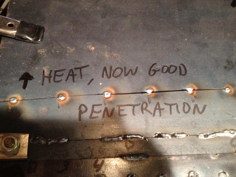

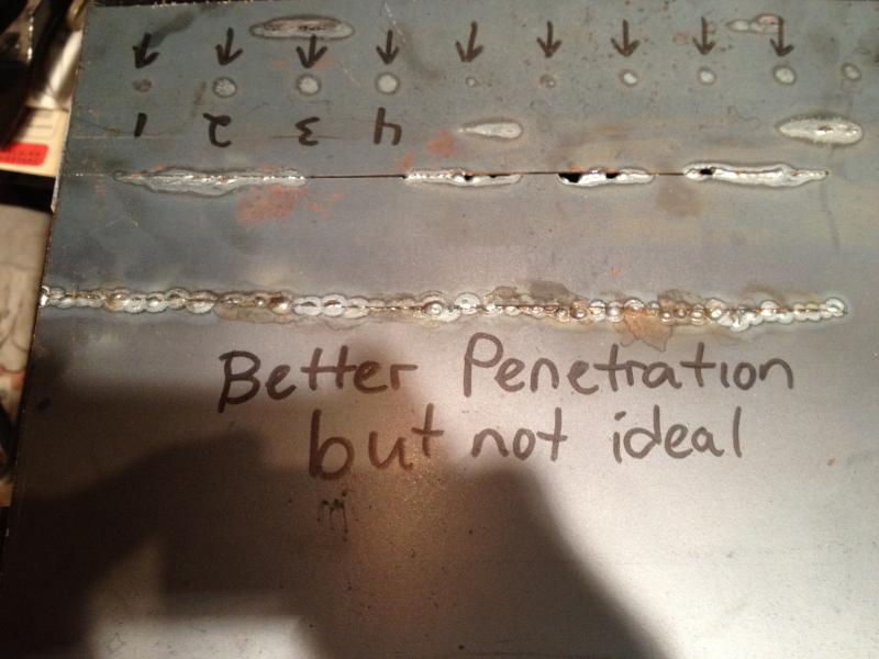

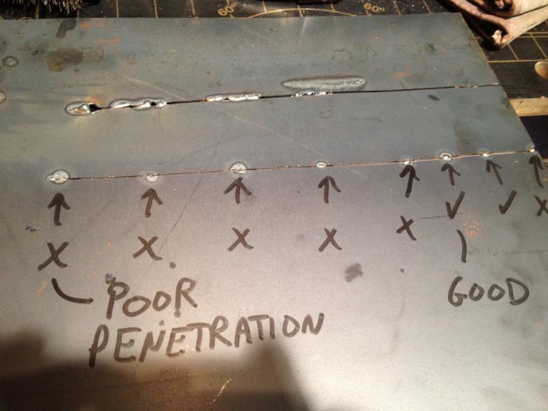

So first: From my post with the plug welds, I forgot to show the back. Here you can see my first weld did not penetrate into the metal very well, but number 2, 3 and 4 did. #4 was my "prized" plug weld, and it shows on the back too.

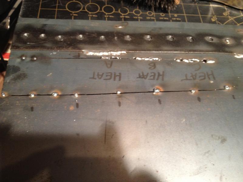

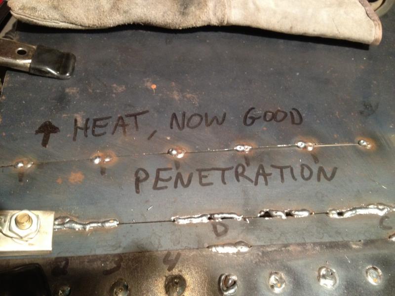

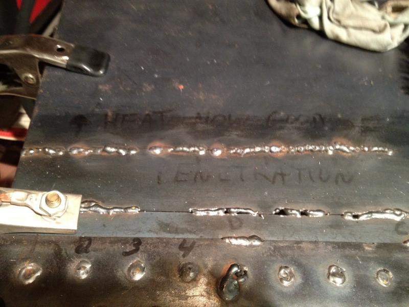

Then I tried to make a new cut and butt weld it together. I first welded several spot welds on the top...

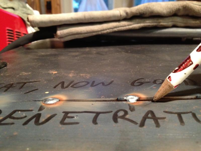

And when I looked underneath, they did not go deep enough into the cut. They were really just sitting on top of the metal.

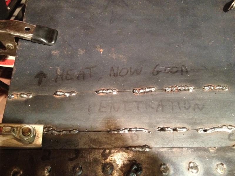

So I re-did the cut and spot welds, and turned up my heat from 2nd notch to the third notch. Good penetration with this. Lesson learned (as stated in earlier posts by others): Most beginners use too little heat...

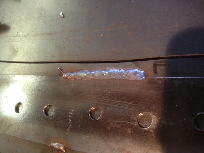

Here you can see what happens when too much heat warps a panel. This happened on my earlier welding trials, and you can see how much it affected the panels. In this case, I was really trying for good weld penetration, so I didn't worry about it.

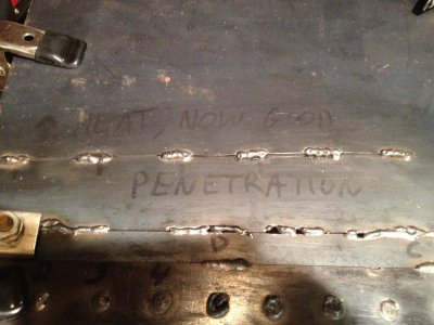

Next set of pictures progress through adding small spot welds to close up and create a continuous weld.
This last one shows the penetration under my new weld. It was much better, but there were some cases where I could still see the cut metal.

Still looks kind of cold... maybe slow down just a little, turn up the heat &/or even better yet turn the wire-feed speed down some, keep the tip close with out sticking it in the weld, experiment with torch angles, especially while practicing, try turning the CO2/Argon gas up or down some, a couple PSI maybe, depending on metal thickness... than practice, move the torch in an inverted C like )))))))))) or down try hand with parts stood up at like a 45* or steeper angle & try the other direction (((((((( , down to up or up & down or side to side watch the molten puddle more, get a lighter lense maybe & helmet you can see out of better, don't go too light thou... try to make your weld straight & uniform, don't rush, concentrate more, adjust the welder for metal thickness & penetration, they should ultimately look like a row of nickels/dimes laying over each other or a consistent slightly crowned & even weld.... Practice makes perfect.... Welding in wind will effect the weld & gases around them too, be aware of what around you.... Good luck & have fun....
