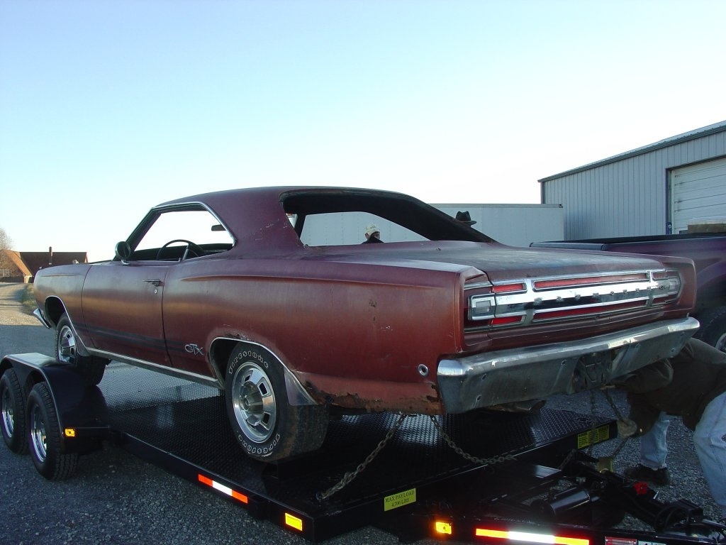

I do try and help on other threads if it's something I've run across with the rest of the car, which I've learned all over again as I went through this one.
As you may recall, this car started as a project and wound up being therapy once cancer hit the third time - it literally was something to get me moving again.
Keeps the mind occupied and distracted from all the physical crap.
She started like this, pretty much all rotten underneath all the way forward:
Every dang part of her has been gone over/replaced/re-wired/whatever since.
The engine is the last of it. I just got to get that right, if for any other reason, so the wife can easily deal with it once I'm gone.
