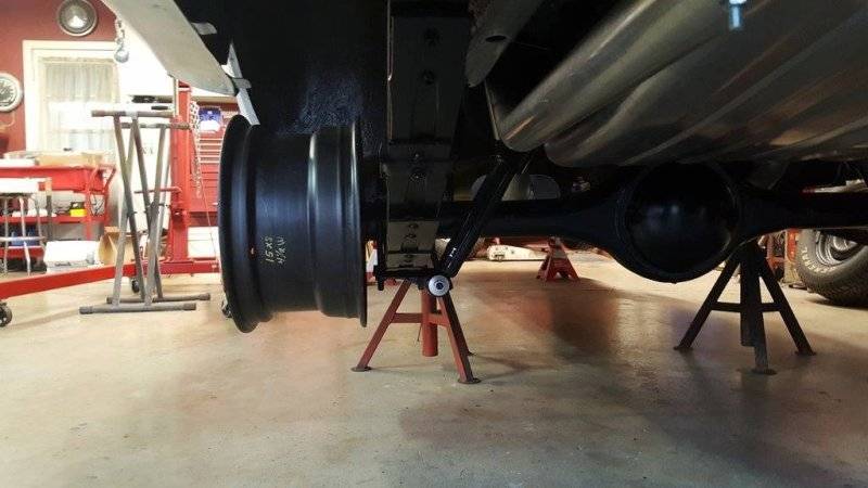

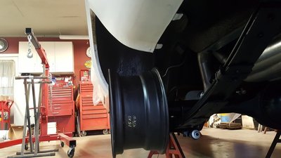

This was my eye balling...
8" width 4 1/2" back spacing. Looks like all kinds of room.

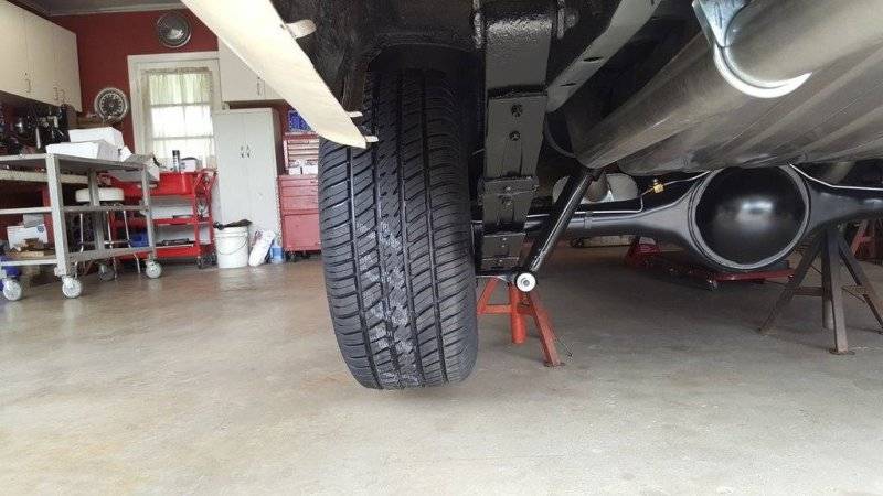

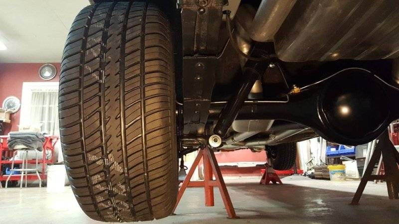

Mounted 275/60/15 Coopers. Too tight to the leaf springs.
After using 1/4" spacers. Should have used 4 1/4" back space.
It looked like the 4 1/2" back spacing was going to work before I mounted the tires. There's charts out there that will tell you the overall tire width on a certain width rim. Wish I knew that. The 4 1/4" back space would have been perfect.

You can't see it in my pictures too good. The clearance between the tire and the front portion of the leaf spring was about 1/8". Almost touching a spring clamp.
