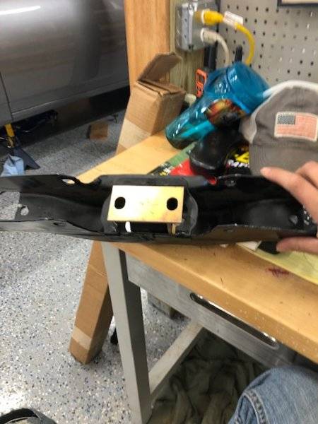

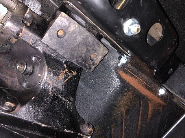

Have a 68 RR and just installed the engine/trans under the car. All 4 K member bolts aligned and started. But the rear motor mount is about 2-3 inches off from the transmission crossmember mount. Any ideas here?
69' 440 with an A833 18-spline transmission late 69. C99129
You have the wrong member and it to cold here to get a picture of the right one. The mount need to set forward of the member.
Problem solved...I have a date coded 10/69 transmission (tail shaft casting C99539) that utilizes a '70 and up Crossmember or 68'/69' Automatic crossmember; therefore my original 68' 4 speed crossmember will not work. The guys at Brewer's rock!
