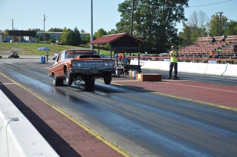

This car has offset bushings, poly strut and lowers. Leaves like this all the time. Close to 1000 passes, 11 years. Front end is still as tight as the day it was built. Drives perfect at 150mph.

Just installing those offset bushings will make it leave like that! I'm getting a set!
:lol:
(I love that car!)
