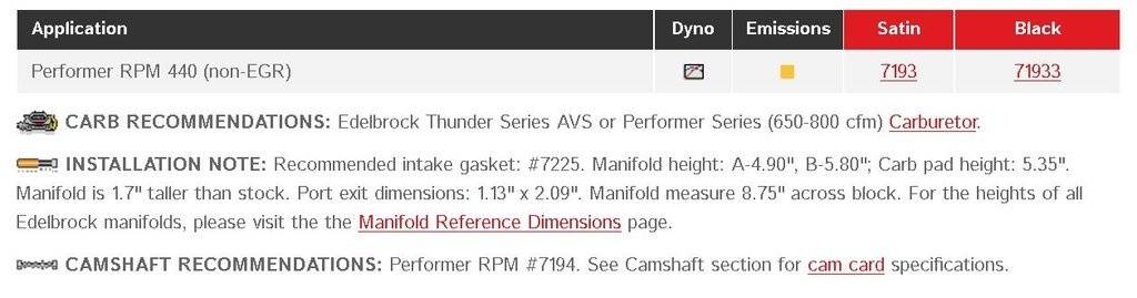

http://www.edelbrock.com/automotive/mc/manifolds/reference-dimensions.shtml
From Edelbrock's site The Performer RPM pad height is 5.35", which, is 1.7" taller than stock.
5.35-1.7=3.65

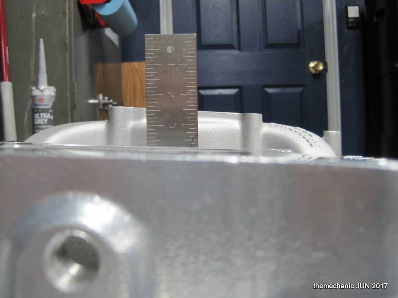

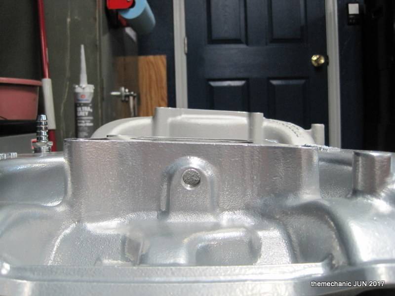

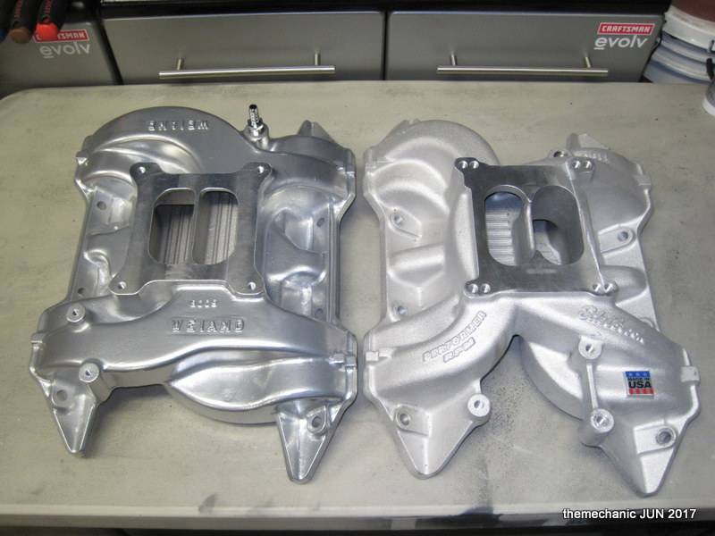

I almost forgot I took these photos with the Weiand 8009 and Edelbrock Performer RPM sitting next to each other on a table top. I used a square to measure the difference in pad height; roughly 1 1/4".
Thx for the good info!
Could not be shown any clearer.
So with a Weiand 8009 I get even a bit more clearance the original.
