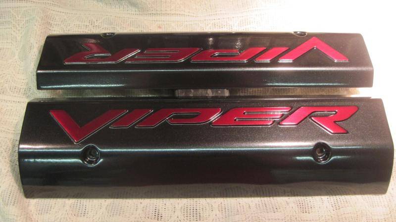

Nothing on my car as usual .... but I did this for a customer's.
Ackkk, no justice under the halogen bench light. Let's go outside instead ...
It's Lollypop Red over polished aluminum logos and Black Pearl. Not much pearl in it but there's a ton of different colored metal flakes.
Leanna,
That looks AWESOME. those are covers to the intake of a Viper, yes? (Not sure what they are, I know that they go under the hood, just curious as to their meaning besides a label, engine "bling"....
NICE tho! That's the new Mopar......

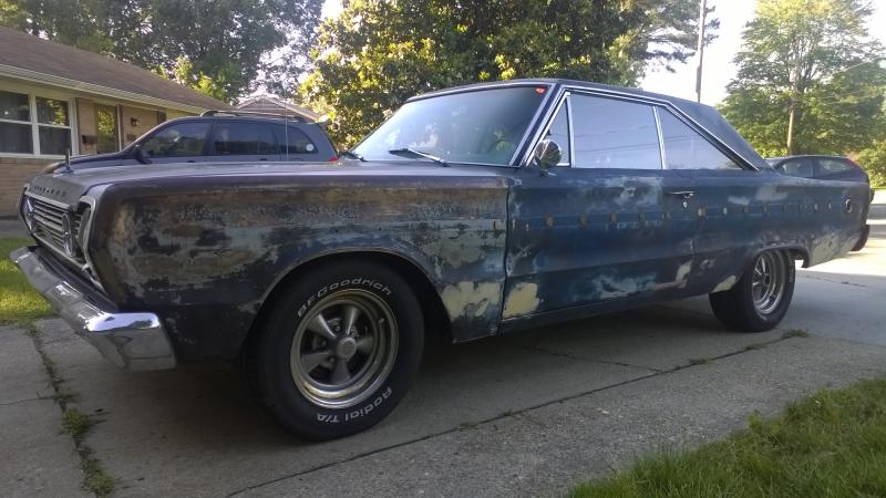

As for me, I found this last week:
383, looks "OK" but notice it has headers, those something possible from factory Ma Mopar?
The hood of this car, was miss-labeled, OR is another hood, not sure which, the block in the car is in fact a 383, BUT, the hood says 440-6.. notice, it has no 6 pack on the motor!!!!!
Needs some under side work tho. brakes and front suspension, but the frame looks solid actually, (I myself, do not care for the rims currently on the unit) but that's just me! Got to find out if the guy will sell it tho, as a lot knows this could be one of those Mopar blue heron......"Gonna get to it" projects that sit and rots in the ground.....But, not a bad find... less then 4 miles away!

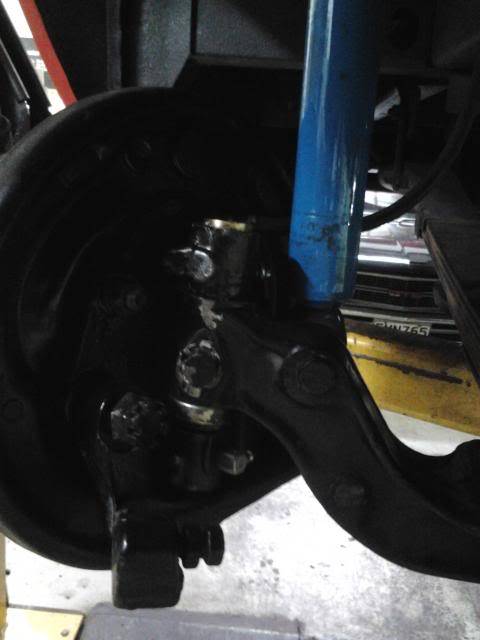

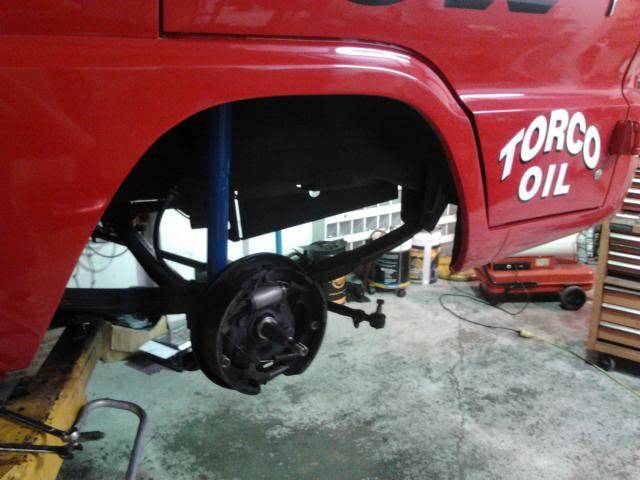

During the last week, my buddy MowPar and myself have replaced the King Pin bushes in my A100. The kit I bought from USA with the truck contained Teflon bushes (likely made from Chinesium) and they failed miserably after a short time. Having only travelled about 3,000 miles, the wheels had top-end play in excess of an inch, which made for all hands on deck when driving a straight line.
The guy at the machine shop who built new bronze bushes for us made a fantastic job, and after installation there was absolutely no play...just as it should be. Not only that, they were a breeze to install because they were so well made. Now the truck steers like it should, and the level of excitement down a straight road has gone :headbang:

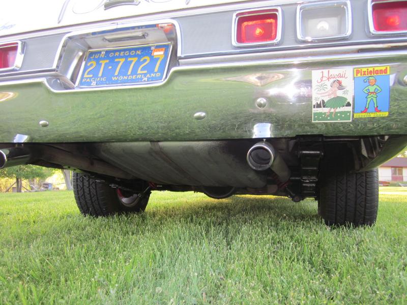

Installed a new gas tank. Hopefully it'll be connected to a running engine before long.

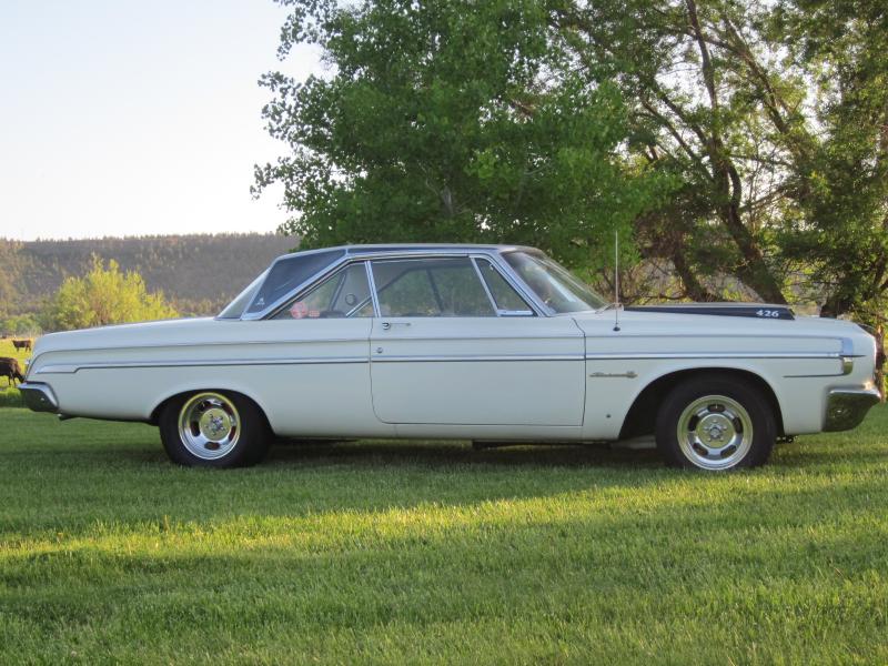

It's actually been the last 2 days. I dug in to my parts stash and did some upgrades on my '64 Polara.
Installed a new set of HD rear leaf springs.
New .960 torsion bars
New lower control arm and strut rod bushings
Moved the calipers to the back side of the spindles and adapted a front sway bar from a '69 Charger
Changed the front wheels out from 14" to 15"
Replaced the rear 7" wide wheels with 8"
I am frickin' beat, going to go have a beer now. This getting old sucks!

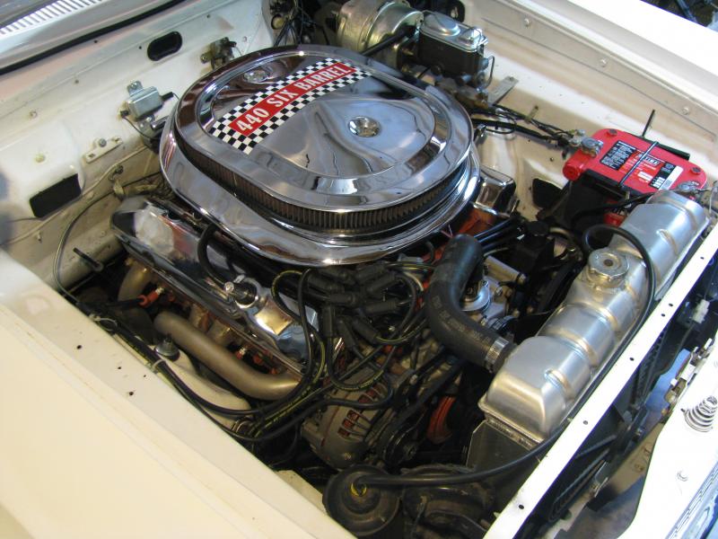

Installed new master cylinder, replaced leaking header gasket and changed to stock vintage chromed valve covers from aftermarket ones.IMG_1947.jpg
