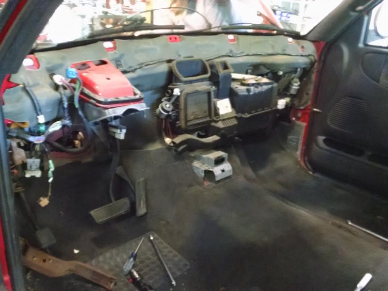

Again not the roadrunner but the pickup.installed heater core and new dash. IMG_20151017_150733816.jpg

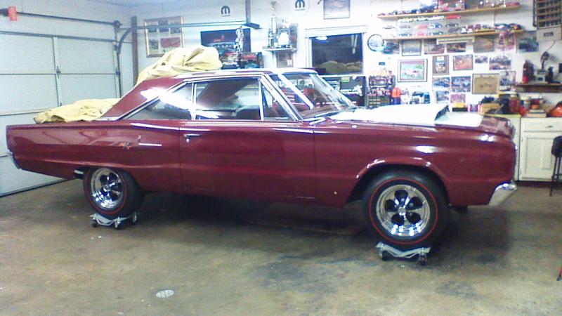

Took off most of the Front Clip plus most of the interior the last two weekends. Now in the cleaning Faze with some of the parts that we removed. 1966 Coronet, Big Block, 4 speed, Sure Grip. One Family Owner!! :)

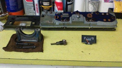

WIN_20151119_181629.jpgGot a head start on my winter to do list. Replaced rear main seal, got tired of the wet spot under the car. Next bought a used instrument panel from fellow member. Replaced temp gauge and printed circuit board now all gauges and dash lights work, yahoo! Last determined that the reverse détent ball was missing causing trans not to shift into second. Replaced it seams to be shifting fine now. Can't say it enough how helpful this site is. ThanksWIN_20151119_181247.jpg
