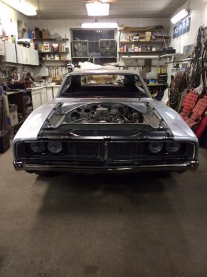

Yesterday I sliced the nose off of the left front fender and began modifying it to match the completed right. This one had a bunch of BONDO on it because it had been hit. It was pretty snarled up underneath but I took the cut off piece to the woodshed and beat the hell out of it to get close to the original contours. I'm going to sew it back together today. Got a start on it last night. I also took the front hood frame off and cut some 1"x 1" steel tubing into 36" long chunks and welded it into the channels up each side in preparation for installing front tilt hinges to it. I took it outside after and sprayed it with self etching epoxy primer. I will be sanding down the underside of the hood skin today and reinstalling the two back together as I need the hood length to be correct for the building of the left fender nose. Once the fender nose is done i'll take them back off and get the front end cleaned up and primered.

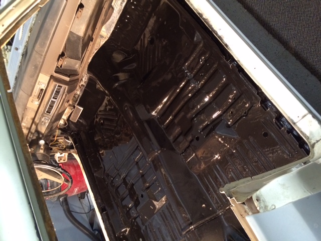

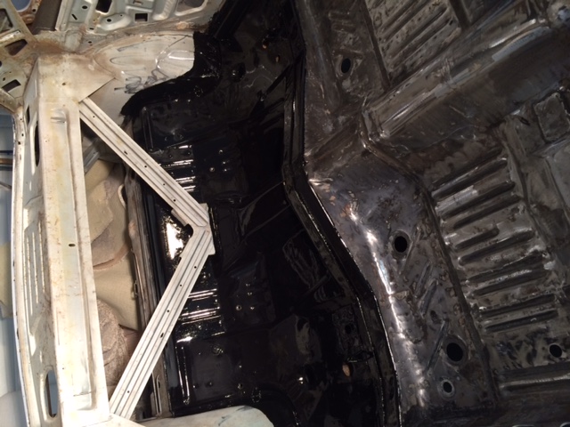

Looking good Dirty! The excitement builds... I spent the holiday POR15ing my interior floors and trunk area, except for the bad place I will replace. Got most of the stuff on the floor and will be "wearing" the rest off my hand over the next month or so. Looks better than the pictures show and that will allow me to move to the next step...pulling the dash! My service manual doesn't really show how this is done so I need to get some detailed instructions...any thoughts on where I go to get a step by atep gentlemen?IMG_0677.JPGIMG_0678.JPG

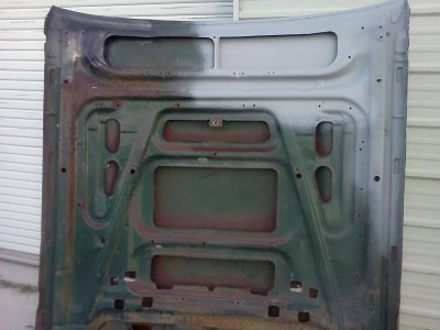

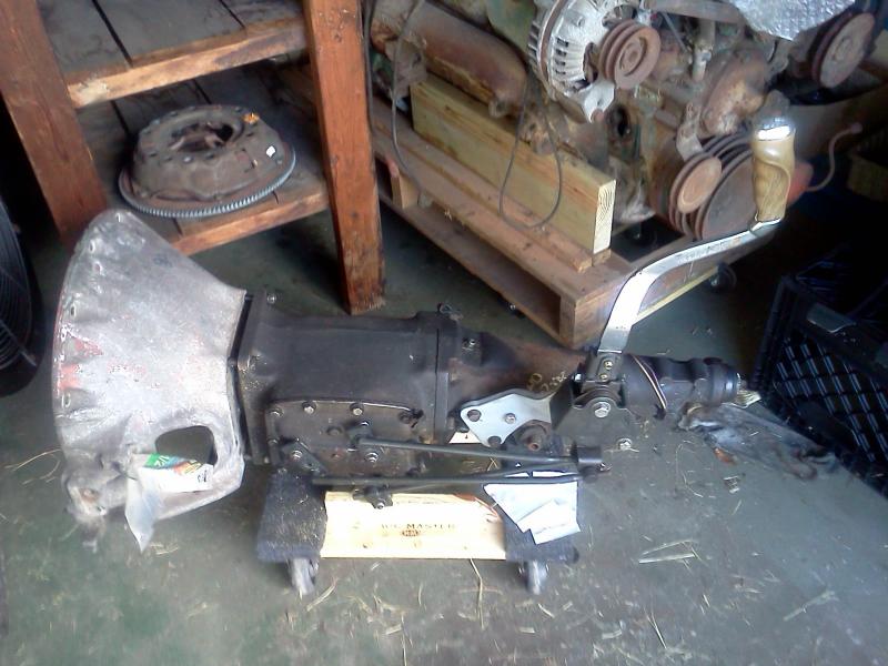

last weekend was decent.
Sanded 1/2 of the header panel to bare metal and primered.
Blasted a section of the underside of RR hood.
Installed and adjusted linkage on future 4 speed project.
Had to disassemble the shifter mechanism (first time) because at some time it had been assembled incorrectly and the spring plate nearest the handle was backwards, preventing full travel.

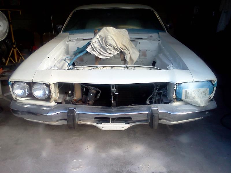

I replaced the damage tail-light housing on my 78 LeBaron. It took 2 hours! Lots of crazy bolts and screws, plus separating the lens' from the housings. It looks Purdy.

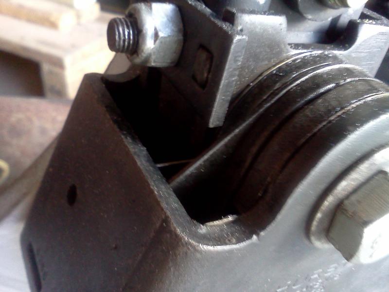

Finally . . .
Think I've finally figured out how to get the transmission mounts on the transmission, up out of the way, and still support the transmission under the car . . .
This task has been such a P.I.T.A. . . . think I've finally got it figured out and almost behind me ! ! !
Go MyMopar.com, scroll down to the section with links to manuals , parts manuals etc. Download for free. You need a service manual for your year and model. It will go along way towards showing how to take off and put back everything.
