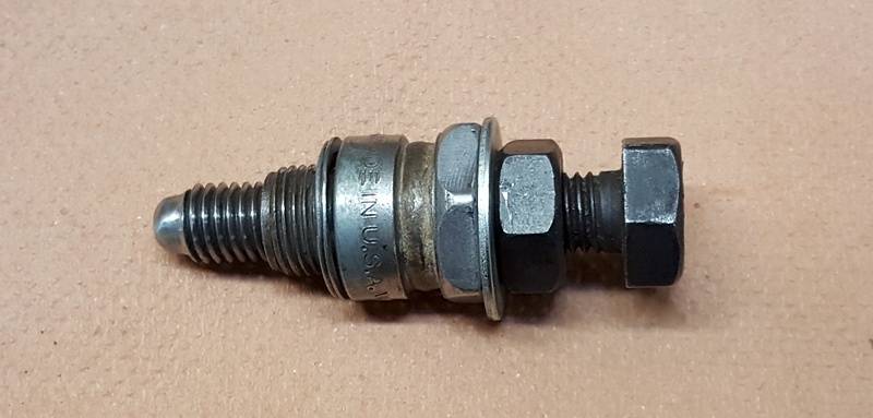

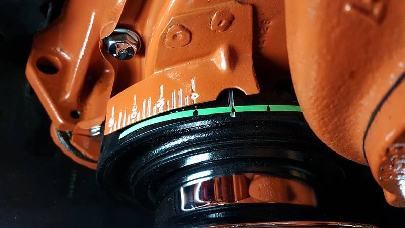

Made a piston stop tool and checked TDC mark location. Looks good:

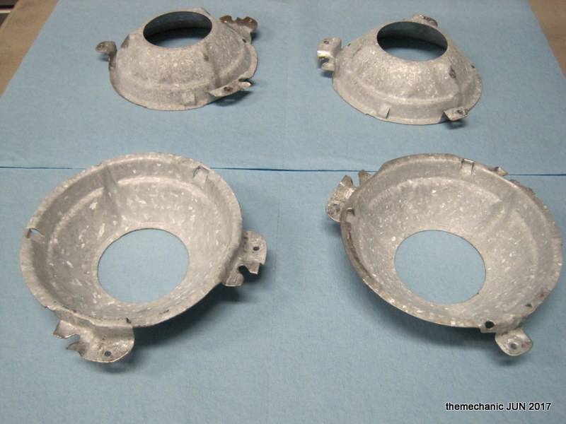

Pulled the headlight buckets for freshening up. Cleaned with 00 steel wool, soap and water then soaking overnight with the screws in Evap-o-Rust.

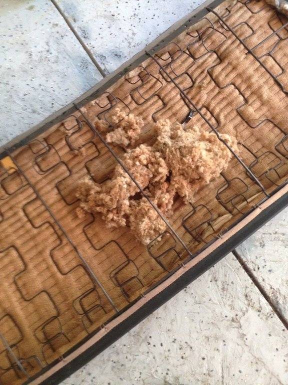

Pulled the rear seat out after 30+yrs.Found a nest,lol.No body so he left a while ago.

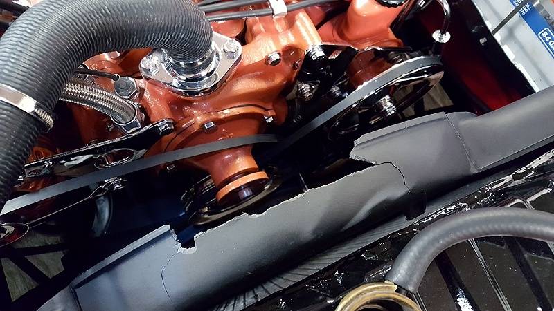

Radiator shroud upper side brokes after installing new engine pads. Made new stainless steel piece and glued it with RTV black silicone:

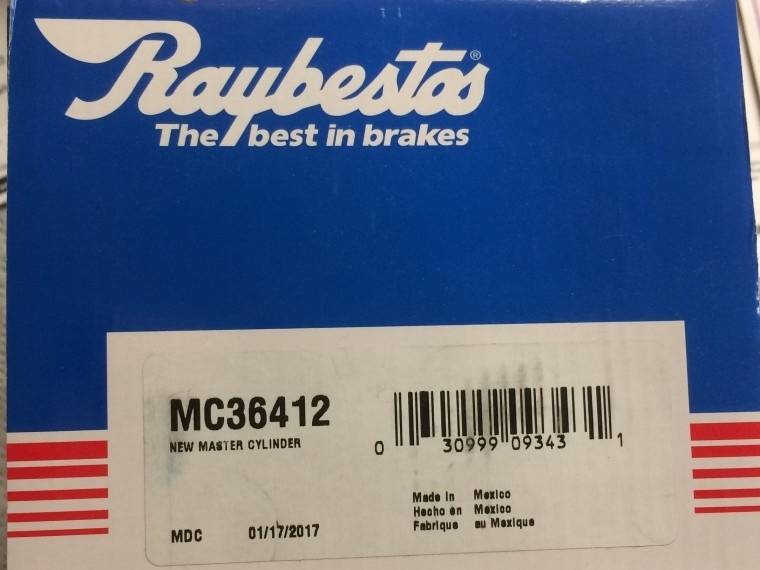

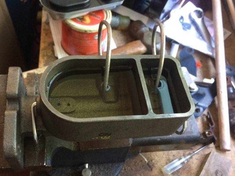

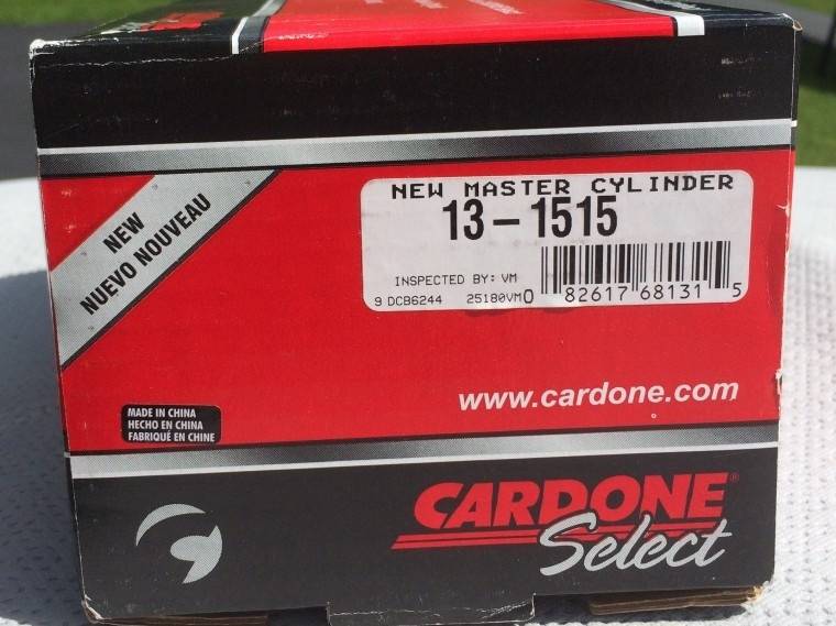

I've been fighting a sinking/spongey brake pedal in the '55 Plymouth. I finally got another new MC, bench bled it, installed it, and it still sinks to the floor. I guess it's time to bench bleed the MC again to make sure, re-install it, bleed the lines (again), and hope for the best.

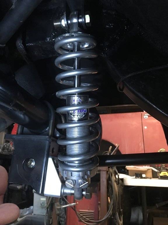

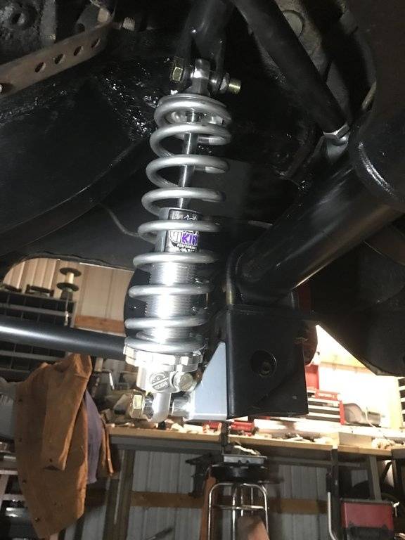

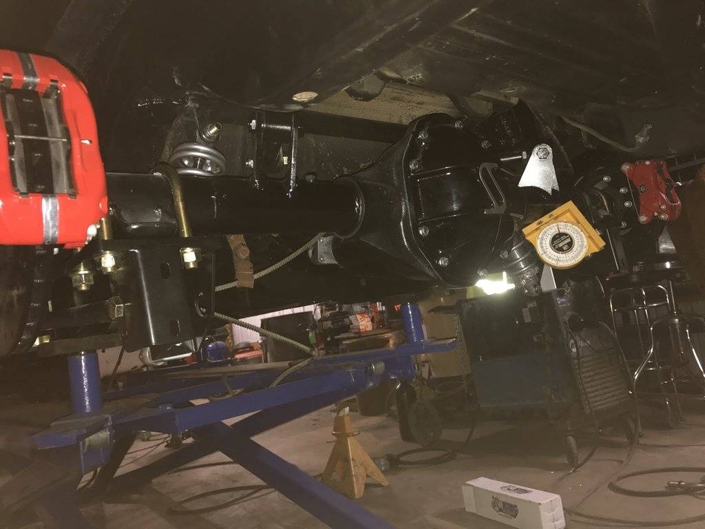

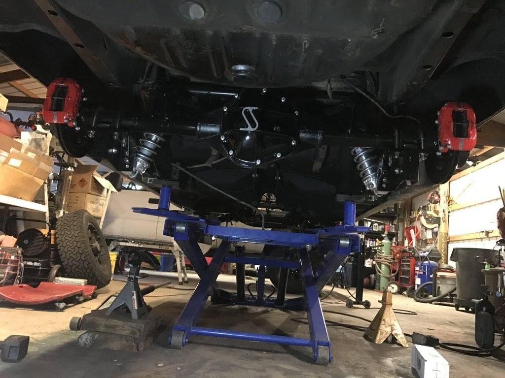

Installed s60 and 4link rear suspension, along with coilover Viking double adjustable shocks.
That reminds me I have a bunch of small stuff sitting in the evapo-rust too. Need to get them out and inspect them tonight after work.
Maybe a leaking whl. cylinder?

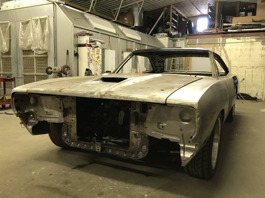

Left the car at the paint shop for the new to me ramcharger hood, scoops and fenders to be re-sprayed and brought the bulge hood home.
An empty garage leaves me with an unsettling feeling.

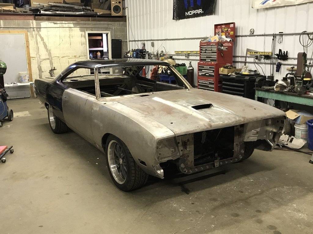

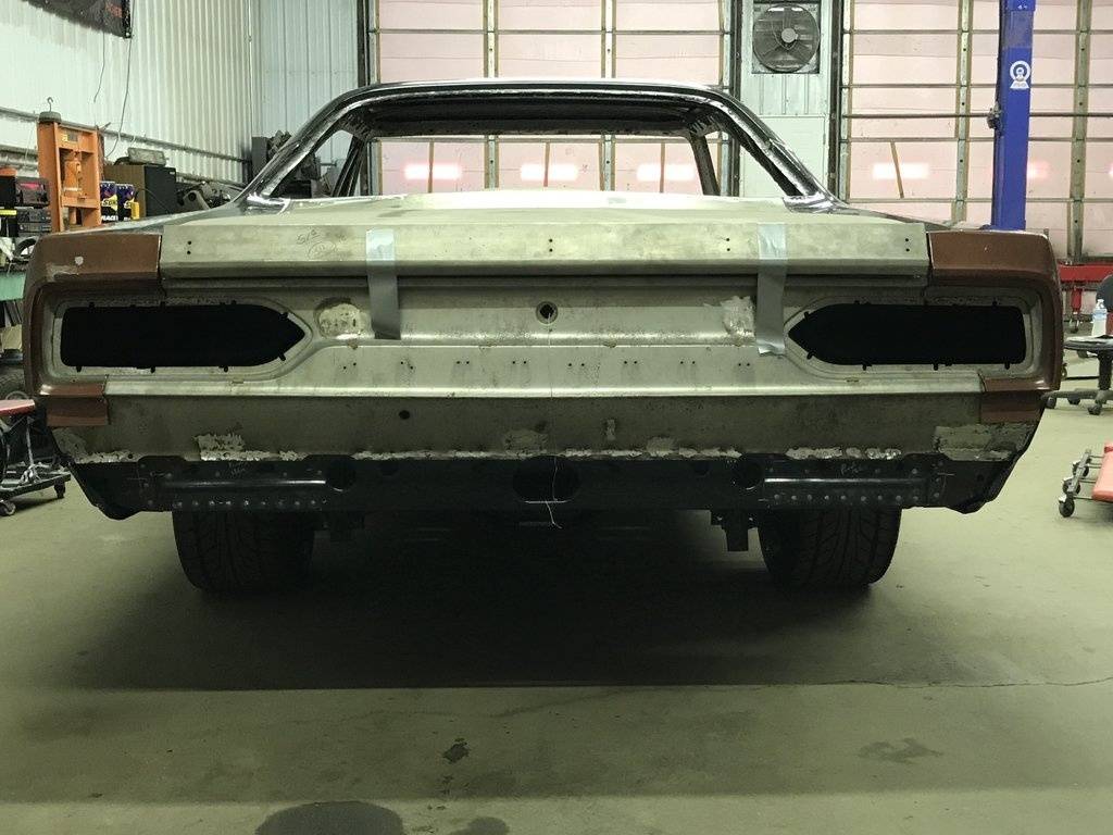

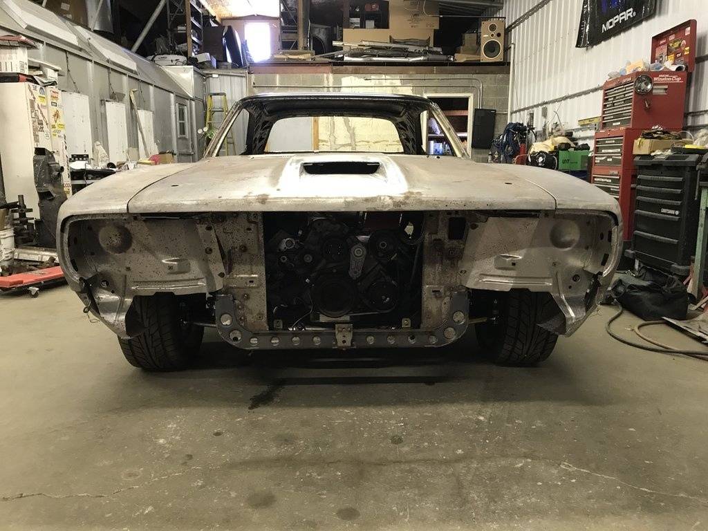

Got the RMS 4 link in adjusting stance an gapping, my body guy killed the hood scoop, exactly what I wanted, kingdigit door handles work smooth as glass.
