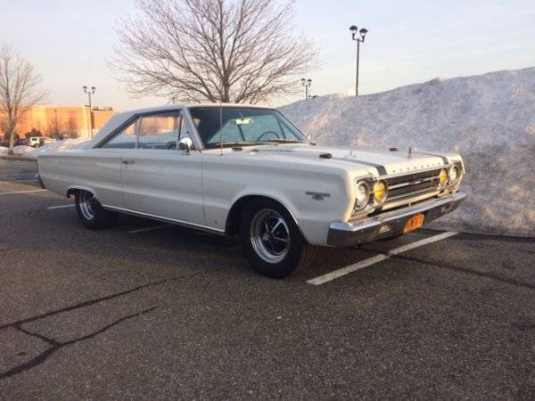

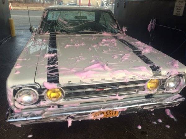

Temps where near 60, and we had a few days of rain to wash the salt off the roads. when for a cruise figure I would give her a bath.

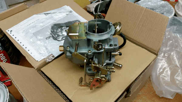

Paid for some parts, watched money disappear from my bank account for other parts, and chased down the local Courier van for a 'MoPar' carb for my buddy MowPar - a 2BBL Carter lookalike. Hope to help him fit that up to his 225/6 Valiant soon.

Looks like you'll need a translator for the instructions!

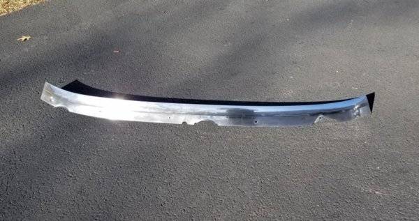

The stainless that goes across the base of windshield was deeply scratched from decades of the wipers running over it. I sanded it with 400, 600, 800, 1000, 1200, and 1600, then gave it a working over with rags and Flitz polish. I stopped at 1600 as I didn't have anything finer on hand and, since it'll mostly be hidden behind the hood, 1600 was good enough. The deep scratches almost completely came out.

5 mins on a buffing wheel with compound real shiny. Near windshield, reflection ?
