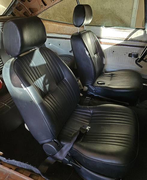

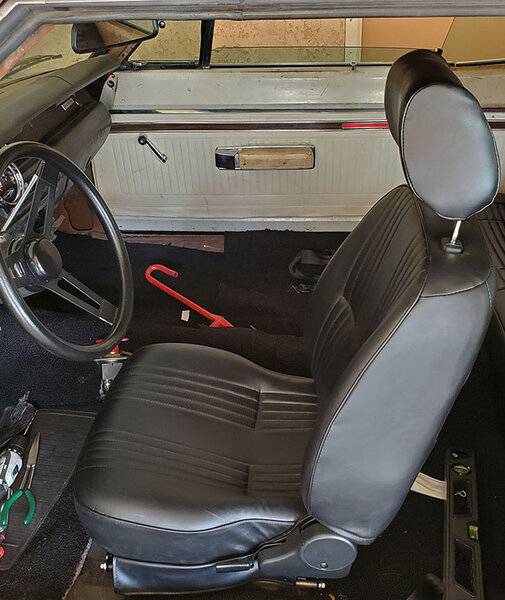

Driver Seat installed.

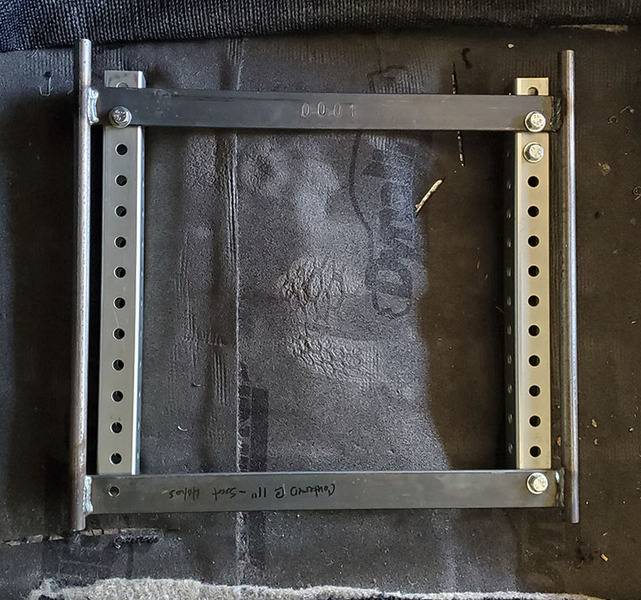

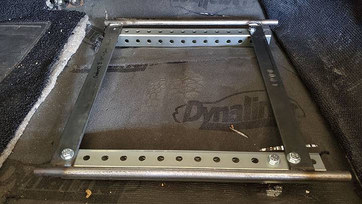

I ordered the seats and brackets early July of this year, I received the brackets within a week.
The seat were backordered about 3 months.
https://www.summitracing.com/parts/sca-80-1300-51l
https://www.summitracing.com/parts/sca-81000
The brackets came with L shaped metal tabs, meant to be bent / cut / welded to fit your application.
Eventually they seemed like more trouble than they're worth, so I eventually used these square tubes:
https://www.lowes.com/pd/Steelworks...c-Plated-Steel-Perforated-Square-Tube/3049419
Cut to 14" long and bolted to the bracket, it worked out well as the perforated holes are spaced out 1" center to center.
The exiting holes from the bench were exactly 11" apart.

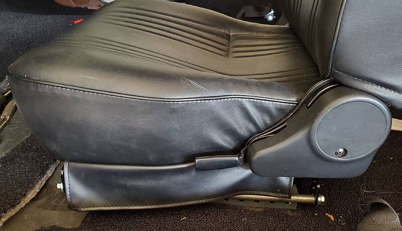

The bracket is then bolted to the seat tracks, there are 3 different height settings.

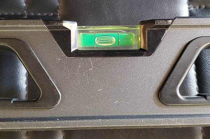

Outboard side is set at the highest (bottom), inboard is set in the middle that gives approx. .625" height difference to account for the floor near the tunnel hump.
It worked out pretty well, I had to cut some of the carpet, Dynamat & foam for better clearance on the 2.5" bolts going through the floor.
A quick drive around 3-4 blocks and I can see my gauges better with better positioning on the accelerator, no more sliding around...
They're pretty comfortable and fit my frame well @ 5'11" 170 lbs. Even with the pull tight lap belt I don't slide around like I did on the bench. Having 4 points of contact (per seat) to the floor over what the bench had they definitely feel more solid. I have yet to drive it through the local canyons in the early morning so I'll get a better feel once I do.

All this so I can take more advantage of the steering and suspension upgraded I've done to my car. These seat are pretty ubiquitous in their application, in all kinds of cars & trucks... They're simple enough to look the part in a late 60's muscle car with more bolstering that isn't overly excessive to hinder entry / exit that doesn't break the bank. Seems like the install (brackets) are the biggest issue, but once solved and installed they're great.

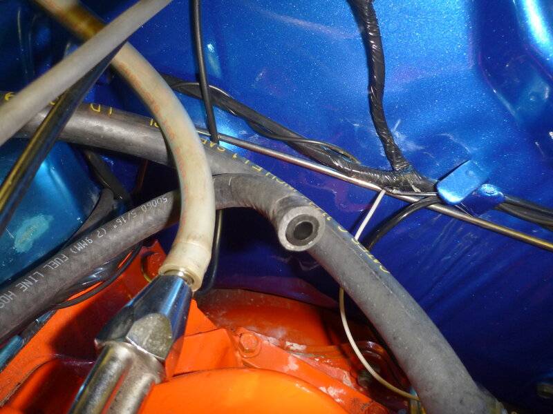

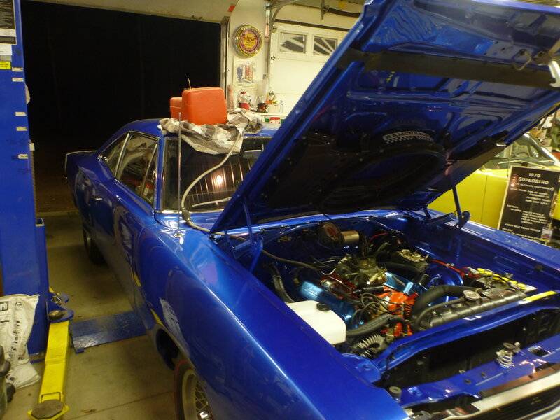

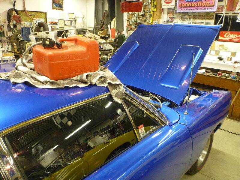

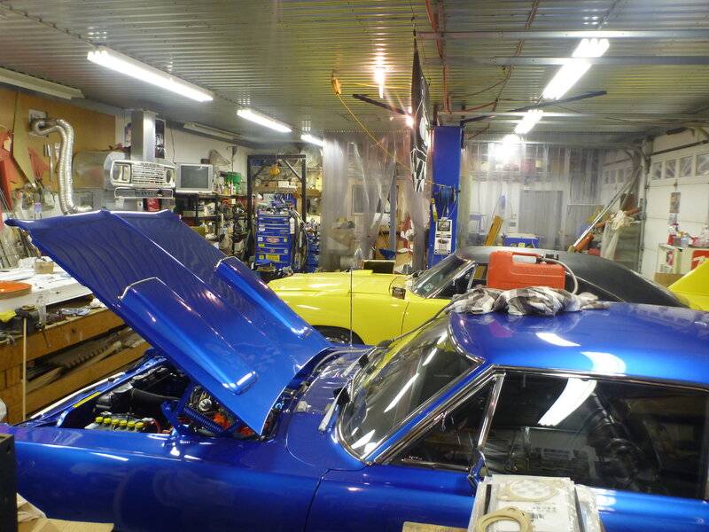

Needed to move the Bee from her bay over to the hoist bay, so that I can investigate whether it's fuel pump or it's push rod has failed. Wife and I were going to push it and then I decided to use my "head". Pressure that is !! Hopefully fixed tomorrow, as it's cruising weather for the next 3 days! Running didn't even pop the "cork" I stuck in the fuel line.

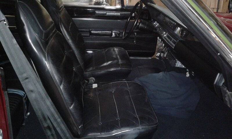

I installed the front seats and new three-point seatbelts, so today I'll finally get to take her out to set the rings on the new engine (since Ohio will be sunny and 70 today).

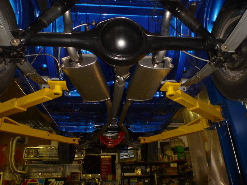

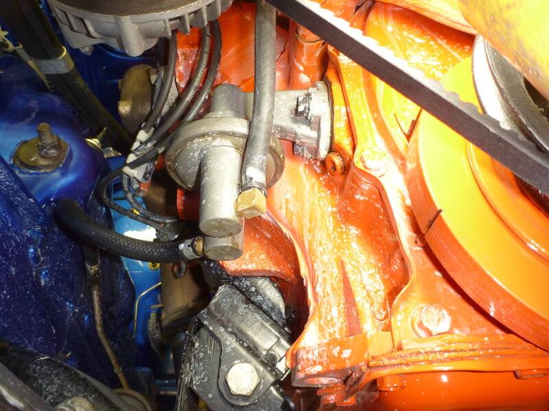

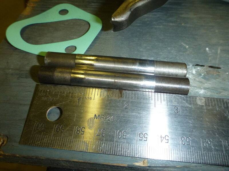

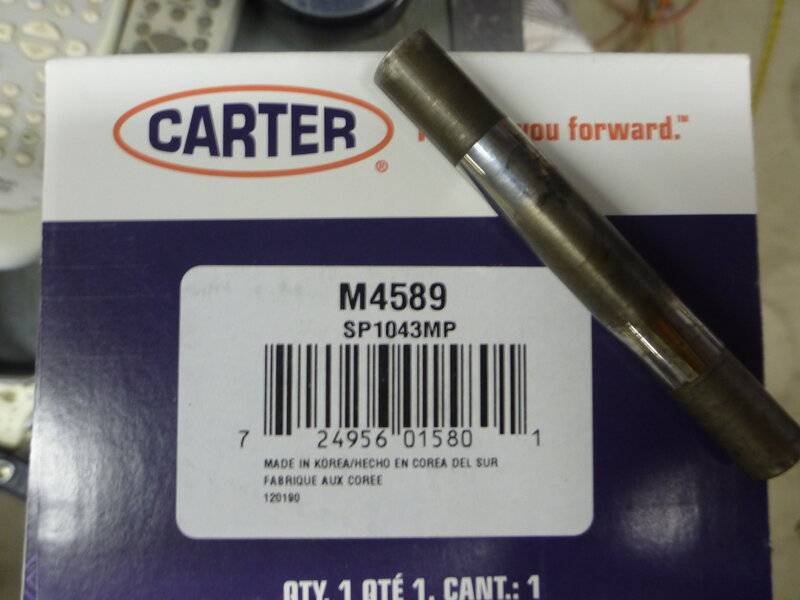

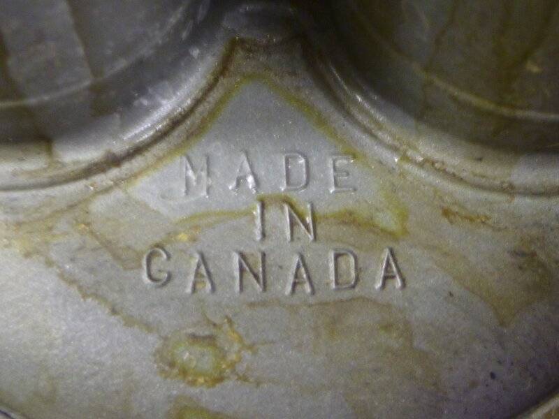

A glorious Sunday. Fixed Therapy up with a new fuel pump this morning, cleaned some more heater hose weep mess off her engine and stomach. Fuel pump, I could blow BACK through it, was toast. Didn't need the spare push rod as the OE push rod, after 51 hard years, was still FULL factory length of 3.22"! Last pump lasted 42 years, but look where it was made! LOL... Just can't believe how much of a mess a weeping heater hose can make. RIGHT back to the rear bumper attach bulkhead..

Good job. Lift sure makes it easier to clean all that drool off.
