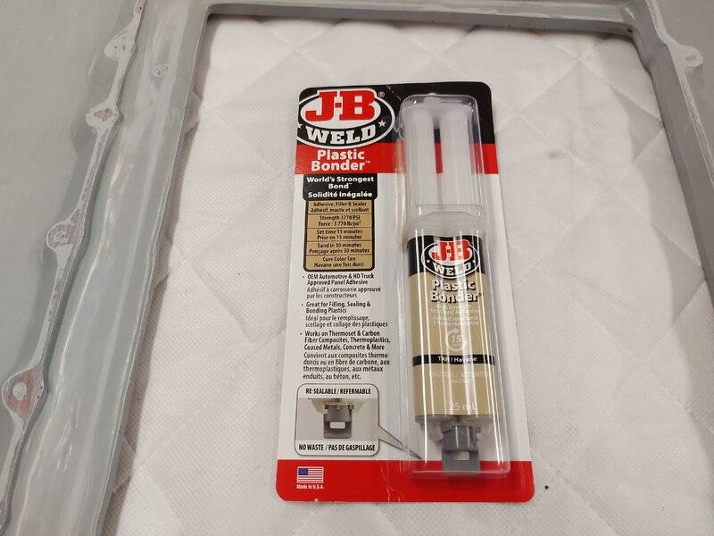

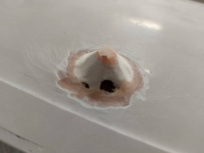

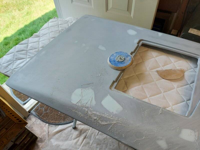

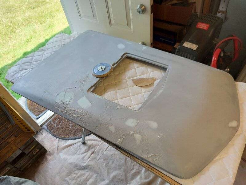

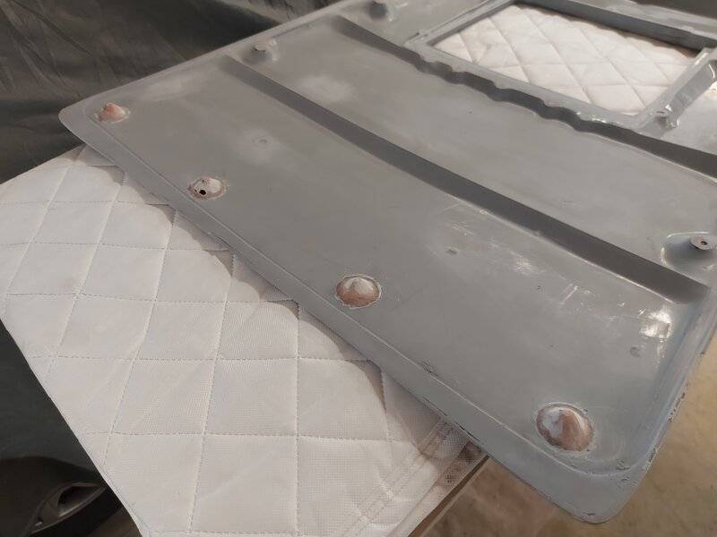

Started prepping the underside of the Air Grabber setup and ran into trouble.
Cleaning up the rearmost cone inserts, this happens....
DOH!!!!
So much for Stinger fiberglass quality.....
I would have thought those cones had more meat on them.

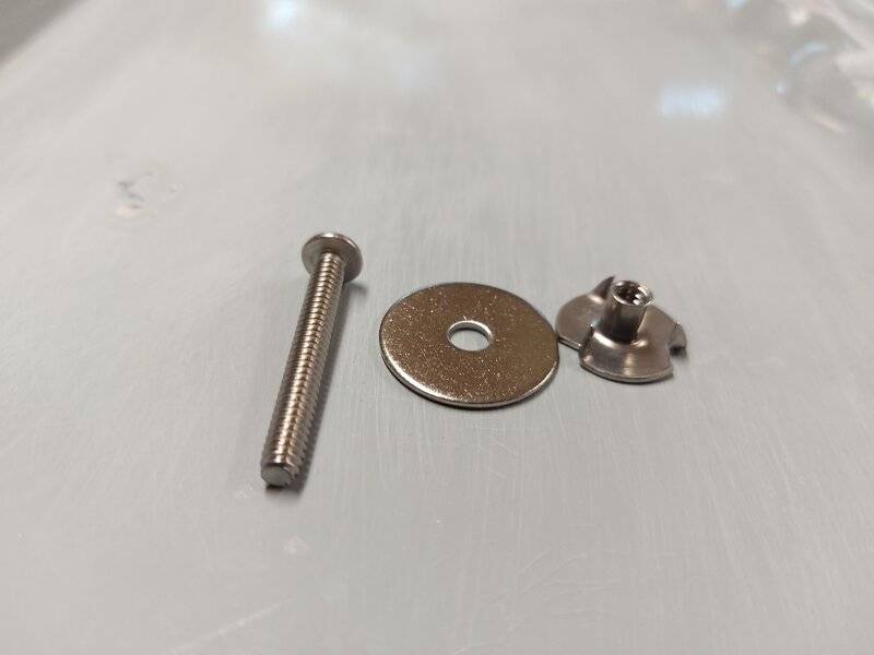

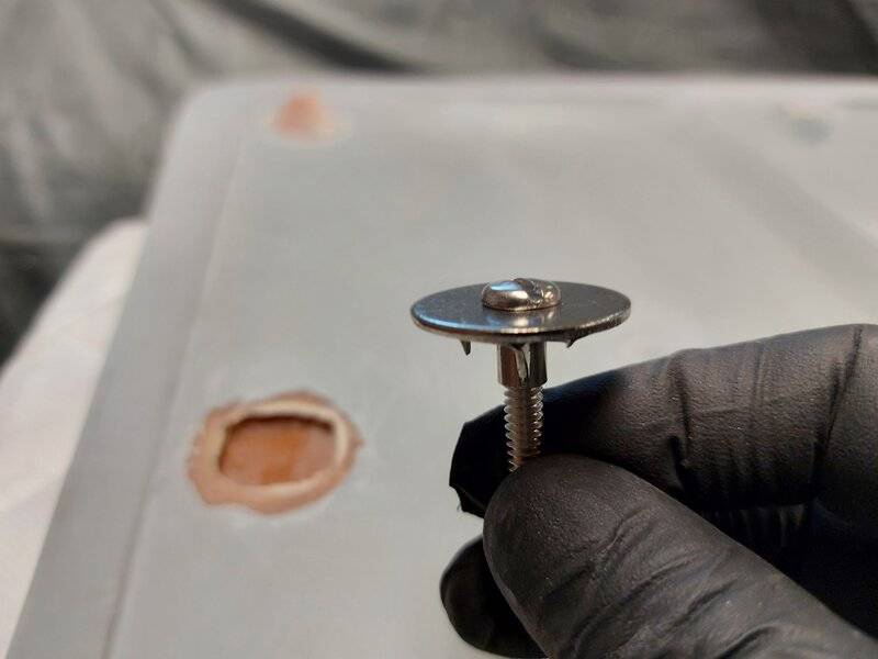

Anyway, I had to come up with a new way to hold the back end of the insert down.

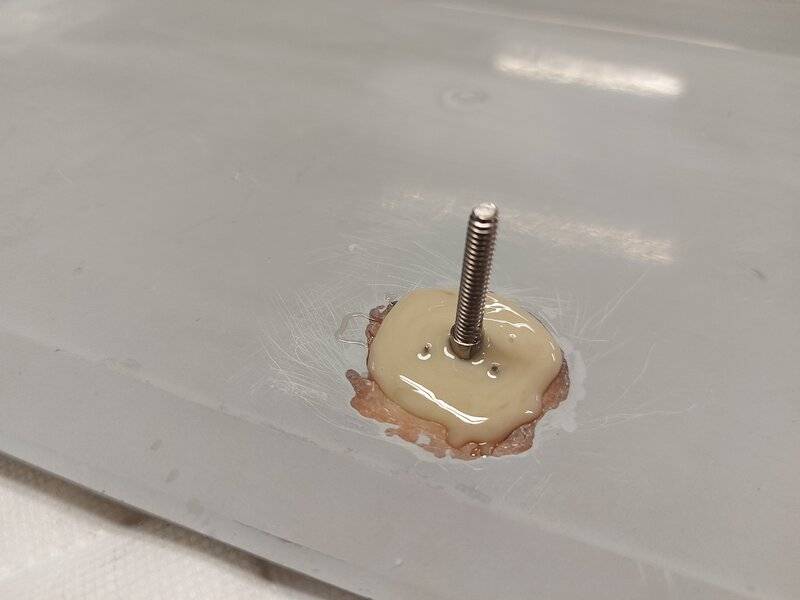

So, off I go to Lowes and pick up some bits.
#10-24 x 1 1/2" stainless screws along with some #10 fender washers and #10-24 furniture flanges.
First, put the pieces together....
Next do a fit-check.....

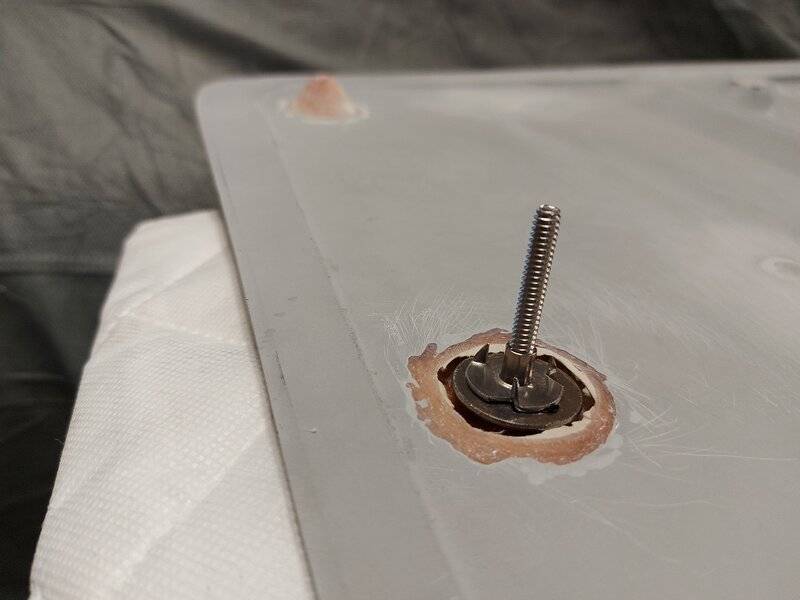

Now, mix up some of this to make it all come together.....
Pour it over the new assembly......
And let it cure.....by doing it this way I should still be able to use the proper bell nuts to hold the back end to the hood.
