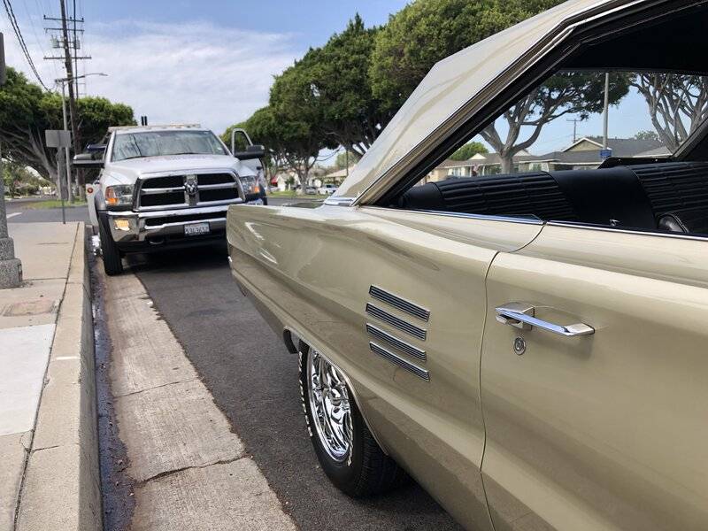

Took the wife and kids for supper and went for a 40 mile drive. Ended up here. Big blocks sometimes like to drink.

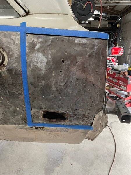

Cut a big hole in a 69 Ply wagon (a lot of damage on that quarter), put it through my plenishing hammer and sorted it out some.

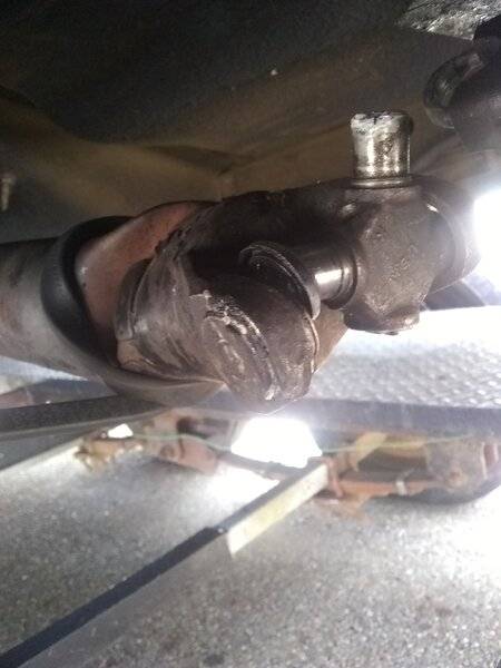

They look ok at first glance.
Happened right on the starting line, and the drive shaft stayed in the transmission.

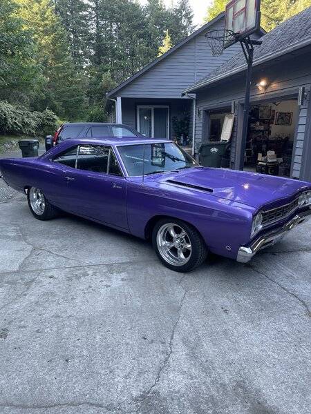

Well yesterday on the 4th I installed new upper control arms on the Roadrunner. Today I have to tackle the rear end. Finally got the SureGrip put together and today its going in. Also while under there the other annoying thing to fix is the incorrect gas gauge reading. I forgot to mention I also installed the correct speedo gear. Its nice to see the speedometer not bouncing all over the place. It had a 24 tooth whiteish gear now has the correct 33 Yellow. I think it may be a tad off but don't want to buy the 32 tooth one. I used GPS Speed on my phone and it seems the speedo gear is 5mph higher. Better than doing 90 at 55 lol

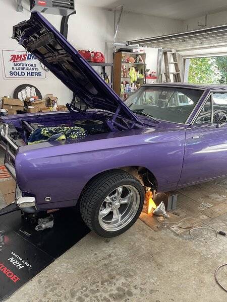

Well my luck is shitty. Spent a crap ton of money and time this morning installing the sure grip and well, it was a total pile of ****. Spent 150.00 getting it setup and I was sure the guy I got it from said it was good. 489 case 3:23 gears new doctor diff install kit. Put it in gear and no go... It tries but slips real bad. Makes an awful noise. I guess I have to pull the heavy bastard back out and have the clutch packs and inside parts checked out. I told the guy it was good because that's what I was told. So I guess its time to rebuild the clutch style sure grip. Should have done it when the guy who set it up asked me. This is what you get when you trust someone.
On a good note got the fuel sender to read correctly.

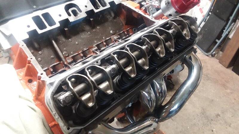

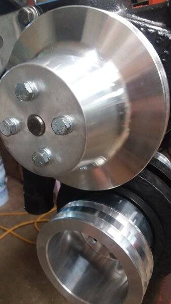

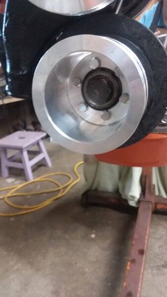

Bolted up water neck, fan, alternator brackets,pulleys and installed new pushrods and mounted up the rockers. Fan was a crusty/rusty old flex fan from the 1980's... cleaned up and repainted. Torqued down the dampener bolt.
