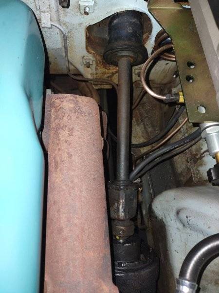

Saturday removed leaking vacuum booster, installed manual stiffening plate and pushrod. braking again.
In a side note the manual brake master cylinder that I didn’t use has these extra fittings. Can someone enlighten me?

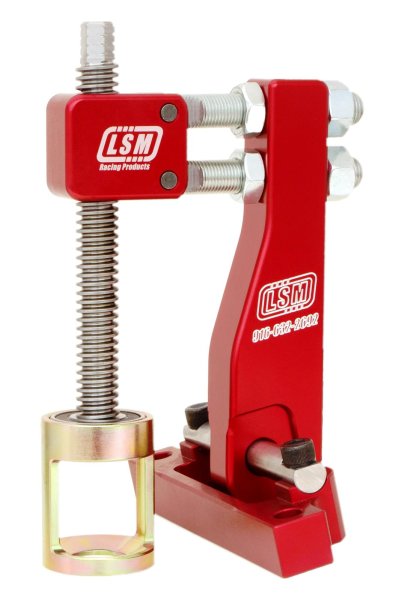

I bought this tool a few years ago and it's worth every penny.

Tell me about this tool. Is it for valve spring R&R while the heads are still on the car? I need to replace the valve stem seals in my 440, but am not wanting to pull the heads off. Where's the tool from, and how many $$?
Yeah they make spring R&R easy and fast without fighting the lever action of some tools. You can buy it direct from LSM or Summit has them.
They are not cheap at $239 but once you use it you will see why it's expensive.
I just use a leakdown tester to air up the cylinder so the valves won't fall down and you can use both hands to put the locks back on.

Does this work with stock rocker arms? I found it online, and it says for use with Jessel Rockers. Im not familiar with them...
