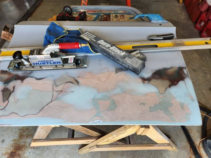

Sanding, sanding, and more sanding.
Repairing poorly done lower panel on driver door

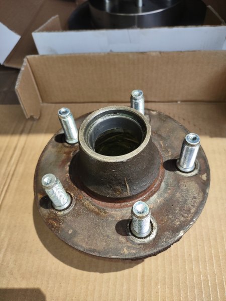

In order to do my Scarebird disc brake conversion, I needed the drums and studs removed from the front hubs, and new studs pressed in. The rotors also needed the hub ID opened up a bit. I was short on time, so I had my machine shop do it. Now I am ready to start assembly tomorrow.

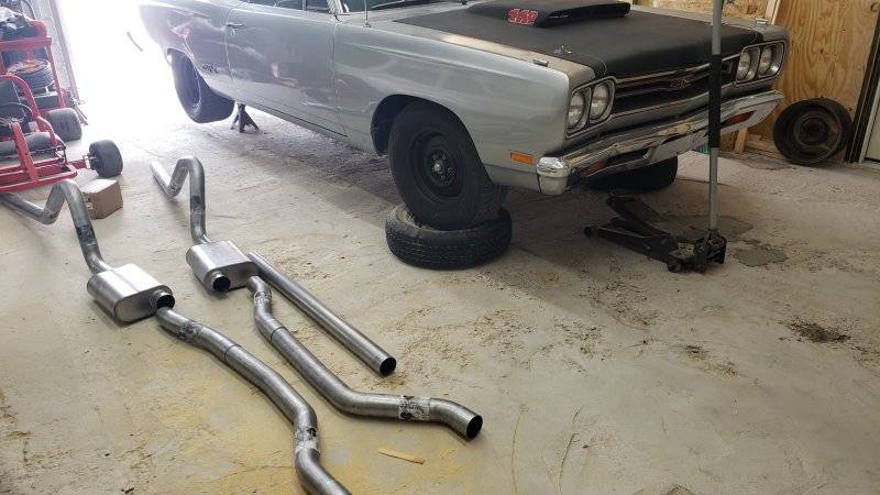

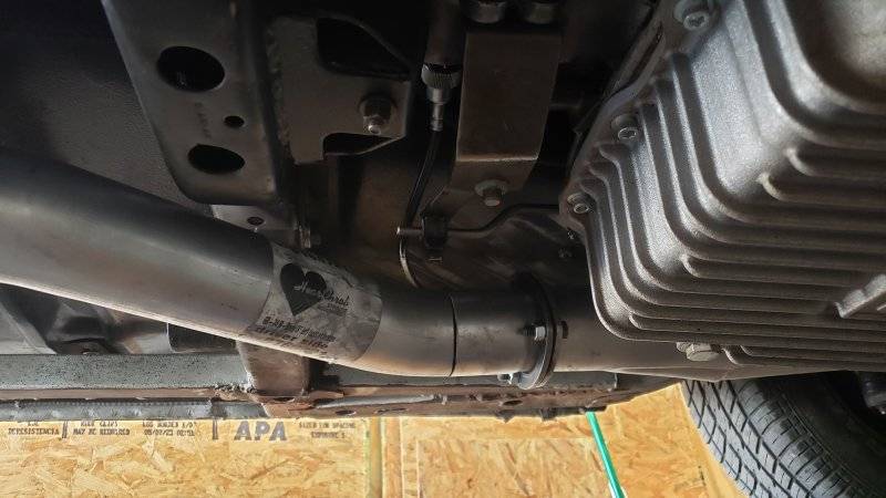

Started replacing my 2.5" exhaust with 3". Got a kit from Jegs and 2 Ultra Flow mufflers. Had to make the driver side shorter to get it through the trans cross brace. I'll finish fitting it tomorrow and get it welded up including a crossover pipe and o2 bung.
I’m going to need new exhaust in the near future, 3” looks like the way to go. Are you going to do an H-pipe?
