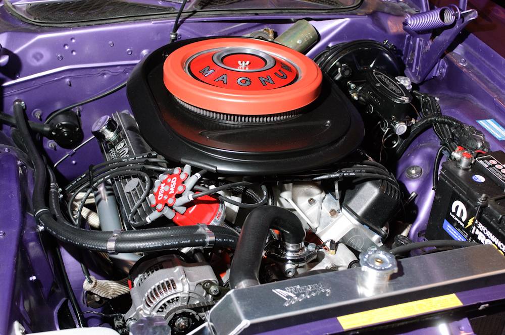

Looking at continuing running the dual plane as I want to keep everything under the hood. So please give me your opinions on what direction to take this build. Below is the current build as is and what I am looking to accomplish. Thx in advance for your time. Feel free to PM me as well if you wish not to post to forum.

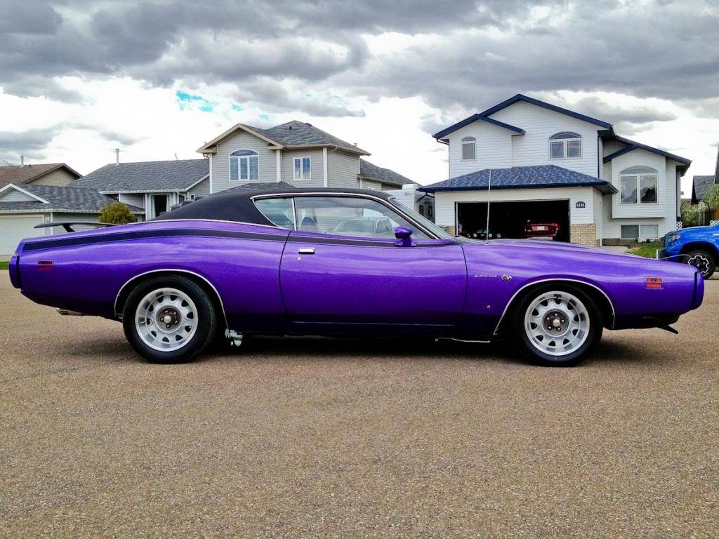

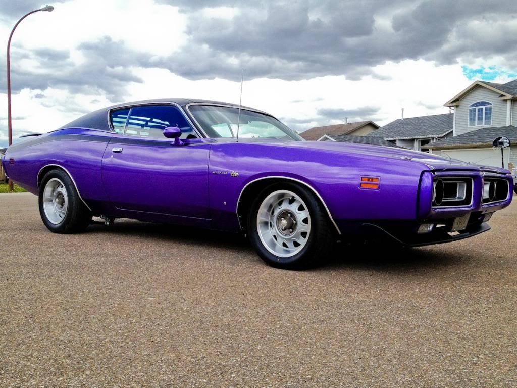

1971 Charger Superbee. 4500 lbs with a full tank and me in it. This is a car that will see mostly street use. I want my build to be one that I am not scared to drive 4 hours to a show yet make as much power as possible with current parts installed without compromising any reliability. Right now I get 16.95 MPG @ 70MPH & 14 MPG @ 80 MPH. Milage isn't a real concern in the build, but that is what it does currently just for information purposes.

Well done, it looks great!

Question? Since the Indy EZ head sits above the valley deck, does that raise the intake manifold any amount? If so how much? Need to keep my build under the hood. Thx.
Holy CRAP that is a beautiful car! I see you have the Comp XE285HL cam. I ran that one and did like it. Unfortunately I ran regular engine oils and wiped out TWO of those cams before I heard about the problems associated with todays oils!
Oh that's gonna be a issue, considering id also use the bigger intake. In my car which i moved the motor back a few inches and down a couple or few inches i didn't have room for an air cleaner.... and ALWAYS always use an air cleaner.
