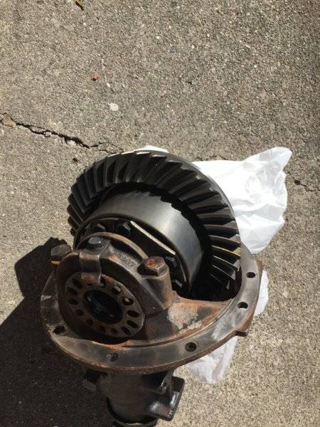

rear is a 8.75 from a 70' roadrunner.
no cover on the back of the rear end
I think that is good news. You would be OK with 3.23 gears too & they are MUCH easier to find than 3.55's. I "suggest" you find a posi center section. The swap takes only about 6-8 hrs. Besides the "pumpkin"/"chunk"/"center section" all you really need is a gasket kit (cheap) and some new gear lube (cheap). And fyi - without overdrive, 3.91 gears make the engine rev so high on the highway you'd swear the engine was about to explode (as me how I know).... like 4000+ rpm "cruising"

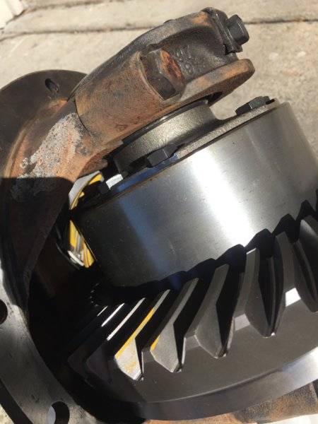

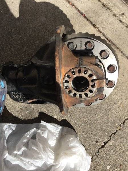

Got a 489 case off craigslists for cheap and sent it to The Rear End Shop in Livermore.
They put a trutrac with 3.55 gears and the works. :steering:

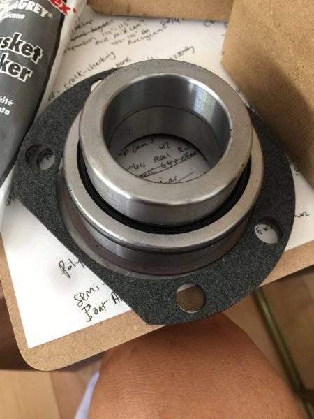

I like my trutrac!!! Just an FYI, if you are using green bearings, keep on eye on them, mine leaked out all the grease from inside, so I put Timkens back in!!!
thanks for the tip. I am using BCA bearings. I havent heard anything negative about them from the mechanics I’ve spoken to.
And of course the Timkens are great. Are they holding up well for you?
No issues with Timken's, and if they lose grease, that easy, just re-grease, cant do that with sealed bearings. They say no synthetic, but I am running synthetic. That makes no sense to me why, its only gears inside. I think once I do my next change in the spring, I may switch to regular 90 weight.
