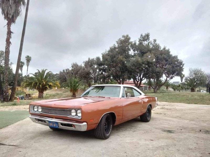

Let me explain my question. I see a 1969 Super Bee for sale. Not interested in it but was just looking at pics. Plain jane car. No scoops or anything on the outside other then a SB stripe on the ***. Bench seal, auto column shift air ccnd. I think a 440. Very plain, smog dual snorkle air cleaner So what is a SB made off? Nothing on this car that looks any different from a Coronet except the rear stripe.

Keep in mind I'm not posting this to talk about the seller. I'm asking because I don't know what all these names you guys use for newer cars, 66 and up. I just thought something called a SB would have some special markings other then the stripe.
Usually it's a Coronet R/T with a smaller engine.:lol:
Nope.
Except for the hood.
Coronet 500 and R/T shared many parts IE interior and tail lights.
440 and Bee shared parts.
Only way to know for sure if that’s not some clone
Check the Dash VIN #
Bee VIN- WM23H9 WM23M9 WM23J9
That car is a"23" body hard top.

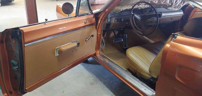

No rallye dash
No bulge hood.
No blacked out grill
