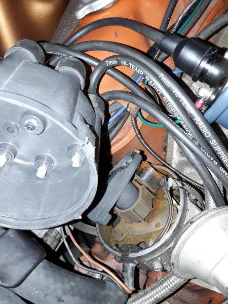

Looking for help identifying this distributor, is it factory? Aftermarket? Style?(i know its not points)..... wanting to purchase aftermarket tach, and the one i picked out says: Functions with breaker points, electronic, and most aftermarket ignitions, EXCEPT NOT MAGNETOS?
Thanks
Found a tag on it----3690431, turns out to be a Mopar Performance electronic distributor, so i assume tach should work!
Thanks again.
I have the same distributor in my car with a Sun Super column tach and it works just fine with standard hook up.
Excellent! Thanks
MP are the same as a mopar electronic the older ones just have a decent curve to it. You will have no issues putting a tach on it.
