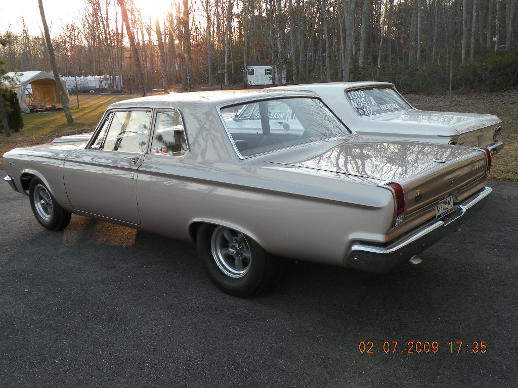

15 x 8.5 with a 6.5 backspacing wheel.its going to be real tight. i dont think the tire will fit. but it might with a 8.5 wheel definitely not a 15 x 10 wheel
OK thanks guys for the help, The 6.5 backspace will work with the stock leaf locations? I will order some rims up. Thanks

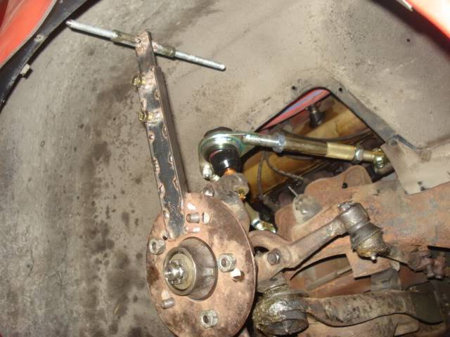

Before going out and spending money for something that might not fit and then having to deal with restocking fees etc you might take a look at this. You could probably make something that would work too since this tool isn't exactly real cheap. Summit sells it for 70 bucks.....
http://www.percyshp.com/techinfo/WheelRite/TechInfo.pdf
OK guys thanks for the help, I will measure it that way. thanks
