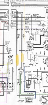

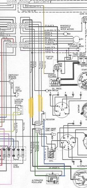

What would be the first wire to check for the highlighted section in picture. Had car running jiggled group of wires that are highlighted and it shut off. Can’t get it to start now. Cranks but won’t fire up. Finally got a multimeter so hoping for a quick fix.

Ballast resistor itself. Although I don’t think a bad ballast resistor would make it shut off but would show up as bad when you try to start it but could be wrong on that.
The wires don’t like jiggling :D
check for power at coil in run. disable starter netrul safety open, and re-check power at coil when key is in the start/crank position.

what am I looking for as far as good power?

Tested ignition coil and got 1.5 ohms and 8K ohms. Pulled spark plug wire from plug and got not spark. But it’s cranking. Checked main spark plug from distributor with screw driver method. Still no spark. Bad coil?
Check BH and cleaned terminals. Fully reseated and solid connection. Anything left to test?
power. basic check that power from both start and crank positions of ignition switch are working. if no power at all, need to check battery to switch. run position engine not running should be > 6 volts. in cranking position, not engaging starter > 11 volts.

Points or electronic ignition? Did you check if there is power at the ignition coil?

this is points. I am getting 4.4v at coil in run position. Assuming I need a second person to crank in start position while I check meter.
Found the problem. My kill switch went bad. Connected to positive side on coil. Had a feeling but never thought jiggling a wire not close to that coil would be the problem. Maybe a coincidence that it happened to fail at that time. All seems well now. Thanks all!

What are you getting at the coil ? The primary side ends there before it goes to the secondary.
