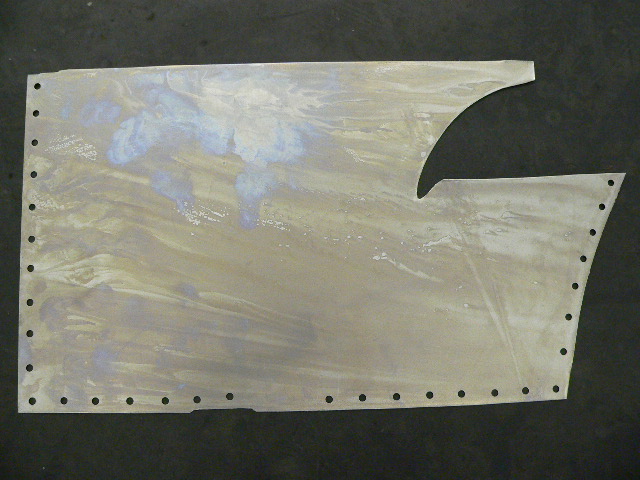

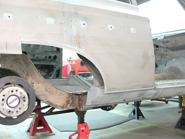

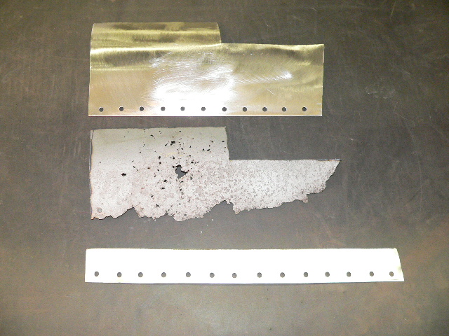

How about a 4.5" grinder with a "slicer" abrasive disk? Works a lot faster than shears and really doesn't distort the sheeting. Plasma cutters work great too...
