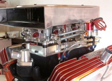

I have a new edelbrock sixpack manifold that i bought for cheap, because someone ( i think a reputable nitrous plummer) had given up on it, trying to get a concealed nitrous system underneath it. I'm just going to plug the 1/8 pipe holes with either aluminum plugs or tig weld.
I know it's a fairly new manifold by the core shift (substantial). This was a 440 manifold.

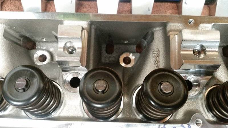

Got the new T.F. 240s today Real nice looking. Compared to the Stealths it is like looking at a Diamond is instead of a chunk of Coal. Hope they perform as good as they look. Now on to picking a cam.

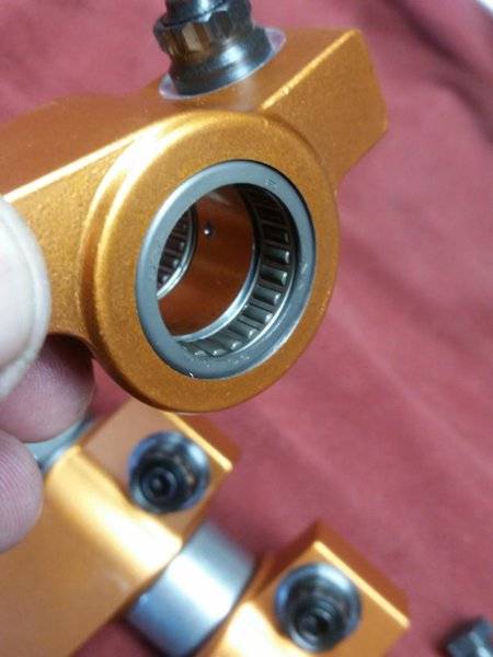

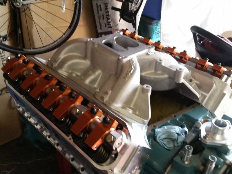

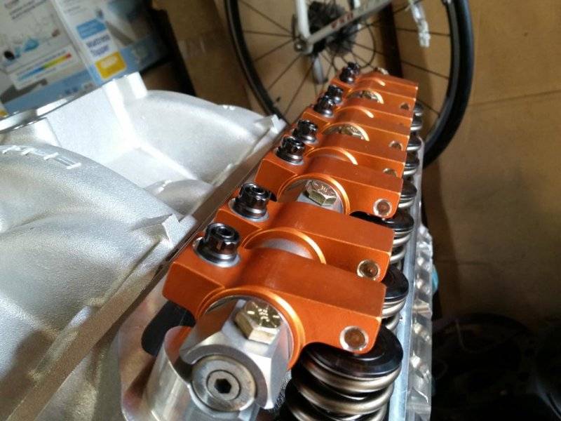

7 steps forward 1 step back. Got all the pistons on the rods except 1 where I fubared a spiro lock. 1 out of 16 aint to bad I guess. Little bastards!! So the short block is on the back burner till I get a new one. So on to sorting out the new TF 240s. Got Source rockers with the junk heads so started putting them on the TFs. One issue is the hold down bolts. Source give you 6 short and 4 long for their setup. The TFs need all short. Also the head bolts wont work. Ordered a 5 pack of ARP bolts for the shafts and head bolts. Was able to get 1 head together as far as shimming the shafts and took a swipe pattern on the valve tip. Perfectly centered with no shims under the shaft. A good day so far time to crack a cold one. As soon as I get down off this hill to civilization will post some picks.

Here you go Wrmryder. This is on the bench, checking the rockers centered on valve.
