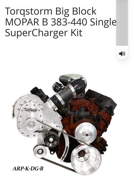

EZ way out? Torque storm super charger, headers, cam, a plus with a RPM intake and good blow through carb.

With this supercharger does that mean new pistons and all that, or will that work on a relatively stock engine?

Anything under 10psi would probably be fine. There’s probably enough wear on that engine that ring gap won’t be an issue.
