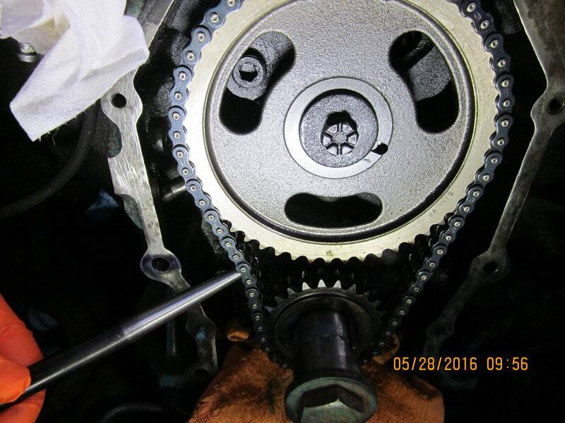

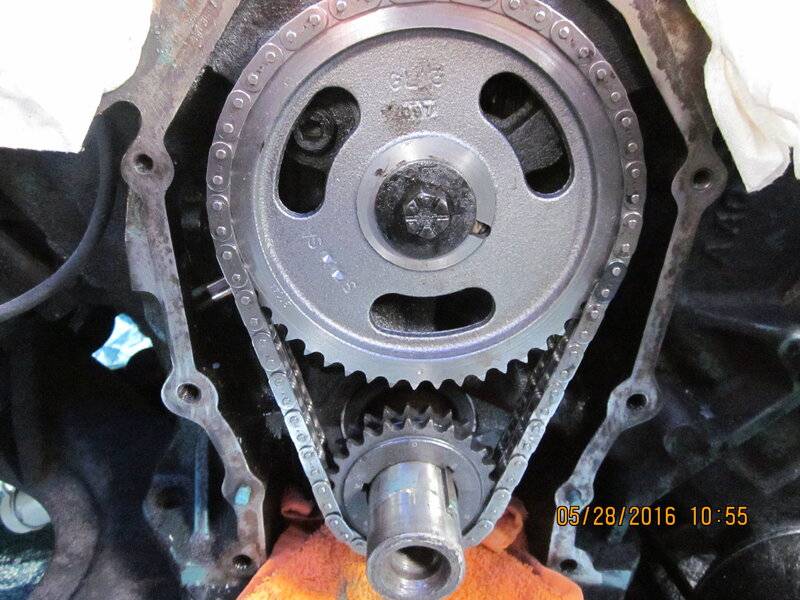

When I graduated high school we spun a bearing on our 440 and dropped in a 72 400 out of my grandparents fury ii. It never ran great even though it had 72k. What we had discovered is the timing chain had stretched. No matter what we did it ran the same, and slowly got worse. We had 3.23, 1 3/4 headers, thermoquad w iron intake. We later put in a used cam out of a 440 6 pack, edelbrock performer, 750 edelbrock carb and then stuck it in a 80 volare w 3.55s for my younger brother.. A new Timing chain made more of difference then anything else. He eventually spun a bearing...but lots of 6k burnouts.

You can get off track easy trying to get an unknown motor to run decent. As others have said start with the condition of your current motor. Timing chain is top of that list because nothing else will be right unless the chain is tight. Big block mopars are hard on timing components.
Pop distributor cap and move the crank and see how much the crank moves before the distributor rotor moves. Another good thing is to verify your tdc in case the chain may have been replaced by a chebby shop and not lined up properly.

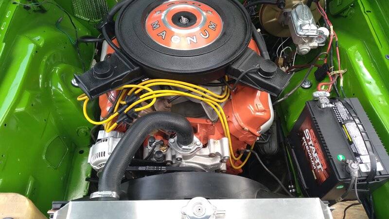

I did this last summer with a bone stock 78 400 4bbl motor with 57k miles. 100% untouched with original trans for $600. Had the original nylon timing chain even. Changed that out with a good Cloyes double roller, straight up just as the factory one was. An Edelbrock Performer intake. Edelbrock 1406 600 and a new set of Heddman 1 7/8 headers I blasted and painted with VHT header paint. Stock timing was 2 1/2* btdc. Still using the original distributor,
I bumped it to 15*. RJ12YC plugs. Stock ignition with an old orange box. For what it is, this thing fries the tires and just keeps pulling and pulling until I let up. 3.23's in the rear also and it screams on the freeway also. I run straight 90 octane gas without the bs additives. Doesn't take much to wake them up. Just start with what the current condition is remembering to stick to the basics and start with the basics. I planned on putting a cam and aluminum heads on this thing. I'm not running it (there will be an occasional 1/4 mile pass once twice in the coming summer) mostly cruising and everyday driving. But at this point, it's staying as is and I'll drive the **** out of it and build on another one. It runs way too good to touch it any further. Don't expect too much. Be realistic about what you have and you'll be happy. Everyone that's been in the car has been quite surprised at how it runs for what it is. Here is how it currently sits (don't mind the pie tin, it's what the AC came with)
