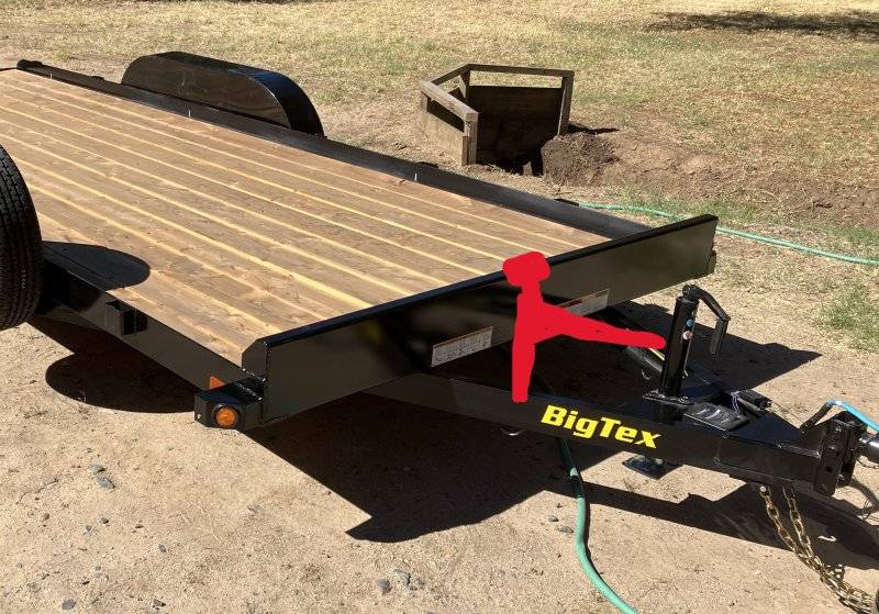

I want to look into a medium duty winch to make this easier. I want something reasonably light that I can mount as needed, then stow out of sight after it has done the job. I plan to fab up some sort of square plug like a towing receiver hitch to attach the winch. I'd do some sort of reinforcement to the framework of the plug...

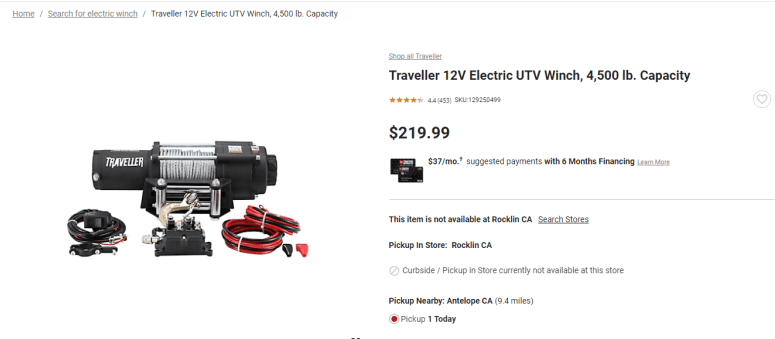

Tractor Supply has this:
It seems that if the dead vehicle still rolls, the rating of the winch might not matter as much? I wonder what they mean? Would 4500 lb mean it could lift 4500 lbs if it were dangling in the air? Pulling a car that rolls isn't nearly the same.

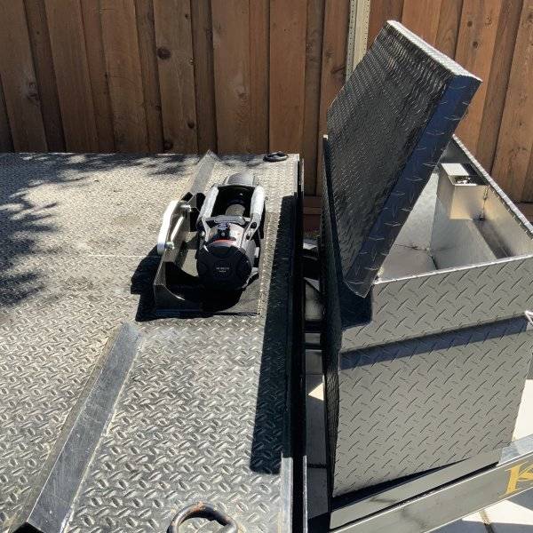

If you have a gooseneck ball in your truck I have found that is the most convenient place to put one. I made an adapter that slips over the ball, and power it up with 2-0 welding cable and Anderson connectors. Store the winch in the tool box when not using it. Mine is a 9000 pound Warn.

The tractor supply one in post 2 with a double line pulled a 1985 Buick Lesabre with a locked rear brake and four flats on my trailer I just pulled for a minute and let off for a minute just to be sure it wouldn't get too hot it was 10 years ago and it is still going after a lot of the same treatment and on the second cable.
It will pull a rolling 4500 pound car on in about two minutes of starting with no release of the button.

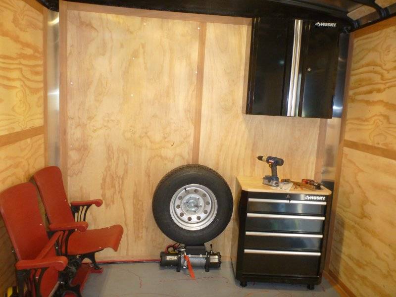

I've had a cheap HF 3500 pound ATV winch in my enclosed trailer for several years and it seems to pull anything into the trailer without any problems. It's setup for the wired remote but I pretty much always use the wireless remote.
