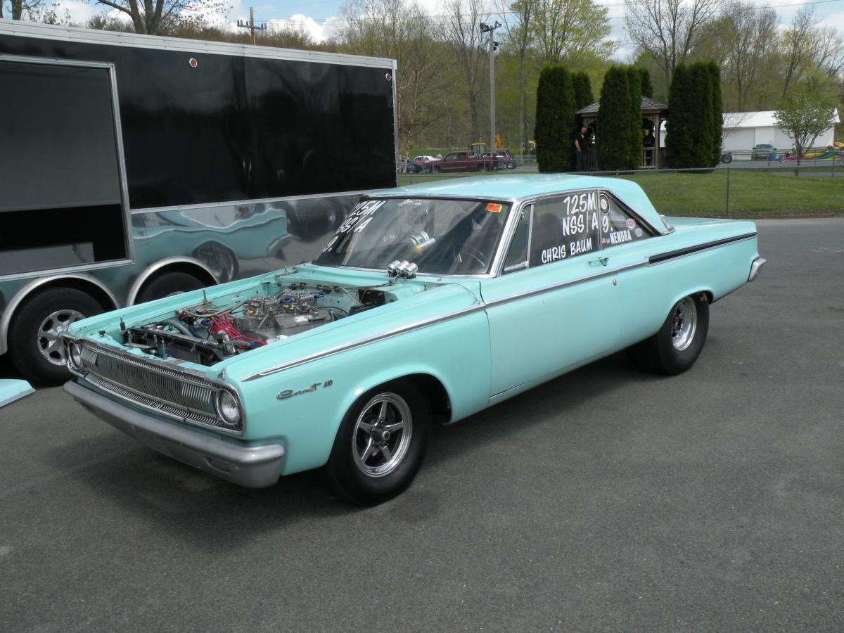

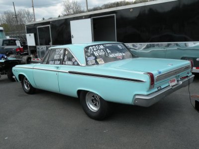

not sure whats making the battery discharge so fast
if you noticed i put on the diamondback carbs after making a few internal changes to them and i netted my best mph of the day. car left great no bogs and the car liked .119 secondary jets which i'm shocked.

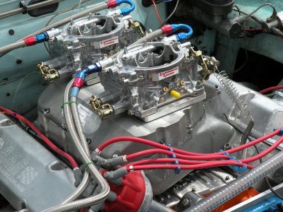

If it likes 119 in the back, you probably need more fuel pressure- most likely can eliminate the weight screws from the rear and pick up some 60'
Tried that and it fell on its face. i put back all the weight as originally came on them and the car just flew. 1.25 60 foot and then a 1.36 on the back tires.
I'm at 6.5 on fuel pressure and it doesnt drop at all even at WOT.I ran .116 all day with a best of 9.06 @ 147.97 until i swapped out the edelbrocks to the dismondback with the larger jets. 9.02 @149 mph with 87% humidity.
I'm running a magnafuel prostar 500 w/ filter.
As you can see i put dual inlets so there's no starvation.
It was a pleasure talking to you on rthe phone and your advice was very helpful.
I love the carbs now!!
I am wondering if .119 in the primaries might also work.
The only enigma I have is the metering rod size now to really fine tune it.

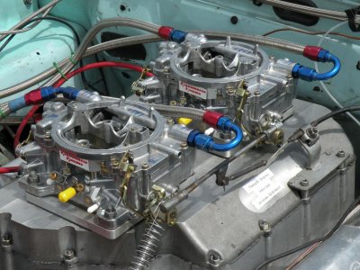

try 7psi and I would try 119 in the front- leave the rod where you have them
damon thanks, going to go out next sunday and try the .119's in the primaries. will bump up the psi to 7 and see how it performs. the good thing is i use a altronics o2 alert and record all my runs for comparison and try to get my parameters around 12.8-13.1 A/F.
