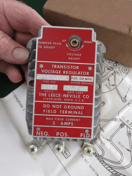

During all of this I ordered a NOS Voltage Regulator from the 70s from eBay. If I'm motivated, I might see if the older ones can handle the extra load from these alternators compared to the newer regulators. But after finding the Leece 65 AMP Regulator I mentioned a few posts ago, I'm not holding my breath.

Note: I added this image to the post after I found another Leece-Neville for sale -- there are quite a few NOS ones on eBay. Nice Voltage Adjust option right on top of the unit. I guess we can figure out how to make these work if they stop making the other ones.
