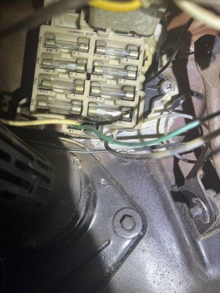

Where do you all buy quality replacement fuses? Looking for my 74’ RR…if there are such a thing.

I’m looking to replace some of my old fuses (maybe I’m over thinking this) but any recommendations on where I can buy quality fuses from?

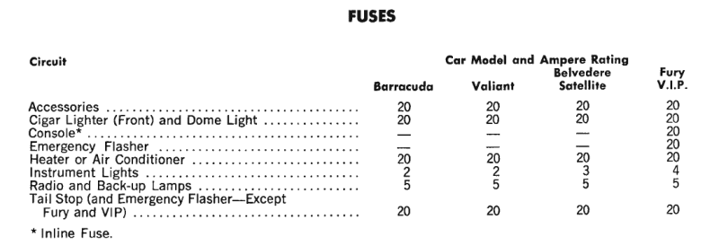

Might be cool to list what these cars require in the stock fuse boxes to begin with?
I seem to remember they're most all 20A on mine, anyways....
But yeah, I'd be buying new old stock BUSS (or the Mopar equivalent) off eBay or some such.

Cool to list but the op may be able to find a chart in a Classic Industries catalog. I have seen a great light bulb chart there. May be they have a fuse list as well. Yes, there were a lot of 20A fuses used but it sounds like you may need to find that chart and change some fuses in your ride before you burn it to the ground. It's worth a check.
What vehicle are you asking for, @tonyp25 ?
Here's the chart for 1968 Plymouth, for example:

Got it! Then if they are working I’ll leave them alone. Very kind of you to offer them to me though…kind of a dumb question but can I test these fuses the same way I’d test fuses with my little kit that I use on my modern car?
Yes, voltage tester or ohm meter
