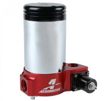

I have run the Holley Blue pump for years and want to upgrade a little, I'm looking at these two fuel pumps.
Holley Black
Aeromotive 11203 street/strip
Which one?

I have the Aeromotive 11203 street/strip pump on my big block Cuda. I also have before and after pump filters, regulator, and return line per Aeromotive recommendations. -8 for all lines.
I have one from sometime about 2007-ish (give or take IIRC)
Street Rod Fuel Pump
Aeromotive #AEI-11203 150gph 14 psi rated (Summit Racing $175)
@ 13.5 volts/draws pretty low amps, for an electric pump
requires a fuel regulator
I use it with a bypass style Holley regulator now
(bypass style helps keeps the pump cooler, doesn't dead head like fixed regulator does)
& fuel PSI gauge, set to 7psi flowing
(use to have a Aeromotive reg., it quit for some reason, had the Holley here so I used it)
all plumed in -6 to the 3 x 2300 Holley 2bbls,
drawing thru an OE style Mancini Racing 3/8" sending unit, (just a streetbeast)
all drawing thru an Aeromotive canister style 40 micron (IIRC) fuel filter
just after the tank & before the fuel pump, mounted lower
up-to the front, with a fuel 10 micron Russell filter before the carbs
& a -4 line off the regulator, back to the fuel tank
thru the 1/4" port in the sending unit
all wired thru an arming switch & thru a 30 amp Bosch relay
like all my electronics have
so far so good, it's not an 'all out racecar', but does very well
for an all out dedicated "real" racecar
I'd have a bit more
but probably still an Aeromotive, just more GPM, larger lines etc.
they have proven to be great products
