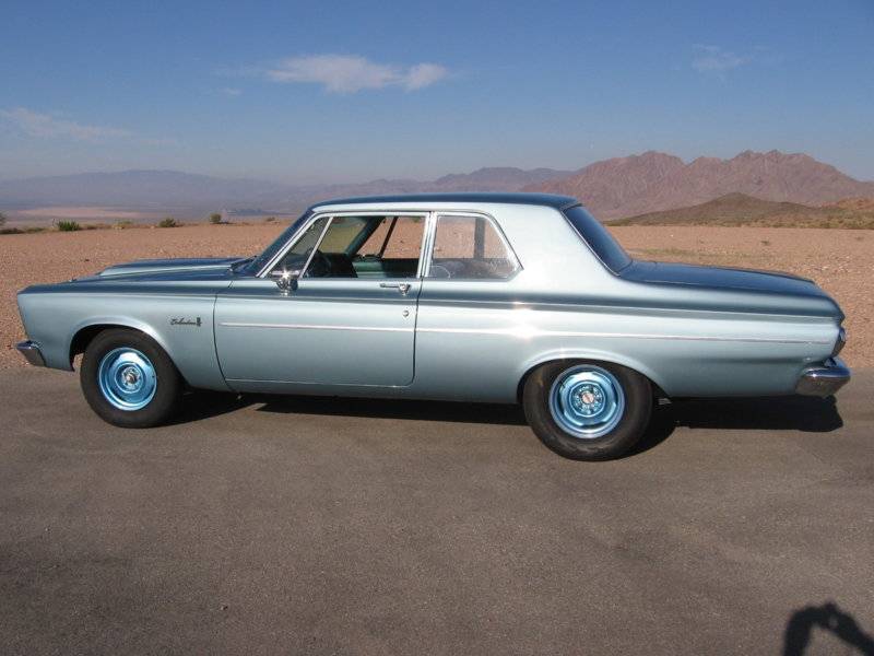

My 65 car with 3400# SS springs. #P3690456 and #P3690457 All steel car 3600 LBS ruffly. It sits level to a bit low in the rear.Front tires are 27.5'' tall and the rear drag radials are 28.'' I believe you should change the front hangers on the 66-up cars with SS springs.

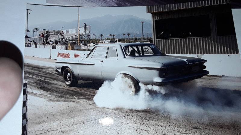

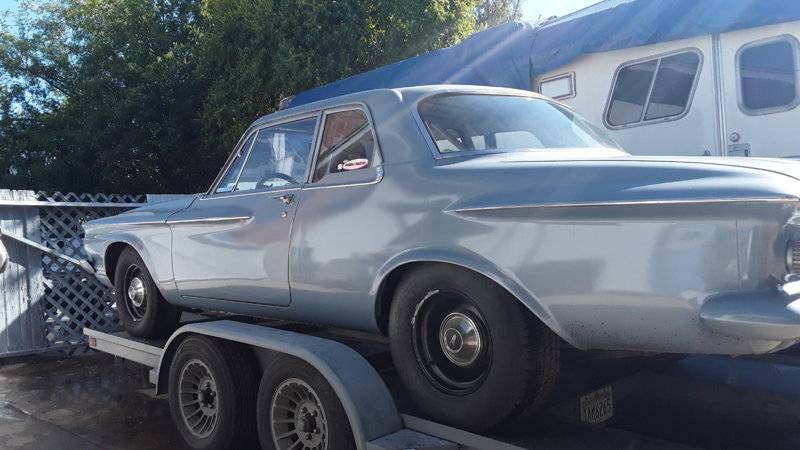

My car with the same springs as Darter6. (Sorry it's on a trailer, needed a parking space).Big improvement over the stock springs. The stockers had too much rearend lift,at launch, about five inches, the shocks would top out and spin. The ss springs fixed that even with the same shocks. Has a small rake, and sits level, contrary to some misinformation out there. Any lower and my slicks would rub.
Best of 1.59 60ft (weak) 11.11 at 122. NOT on these tires.

My 65 car with 3400# SS springs. #P3690456 and #P3690457 All steel car 3600 LBS ruffly. It sits level to a bit low in the rear.Front tires are 27.5'' tall and the rear drag radials are 28.'' I believe you should change the front hangers on the 66-up cars with SS springs.View attachment 826516
Beautiful car, Thanks for the info!
